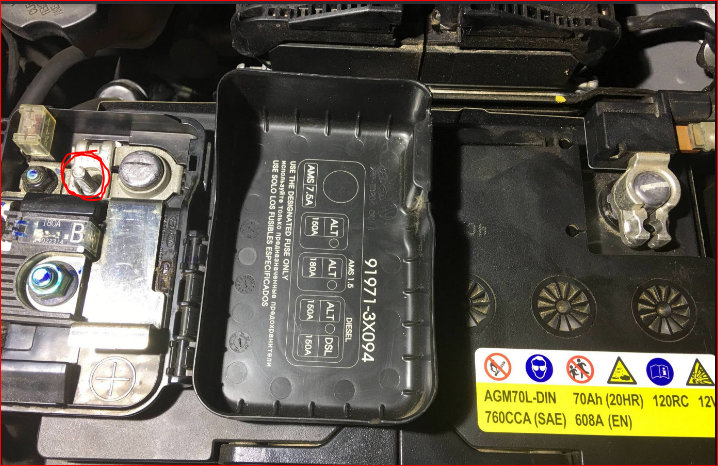

Hello. I am not very handy at all and neither is my wife. She was trying to replace the dead battery of her 2014 Hyundai Elantra SE and was trying to take off the terminals and dropped at least one piece of hardware (she thinks that it may have been a wing nut and then something else) into the abyss. She think it is on the right side (standing from the front of the car looking into the hood) and I tried to use some magnetic pickup tools but could not find it.
Now I am trying to figure out how to properly secure the terminals because I do not know what hardware she is missing.

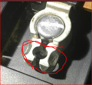

The battery terminals that are on the vehicle are original. The only place you might be able to get the parts is from the dealer. And yes, there are two nuts missing and the cross tensioner is missing on the neg terminal. If you look at the terminal, there are two recessed areas on the sides of the terminal. The cross tensionier that is missing causes the terminal to close as it is tightened.

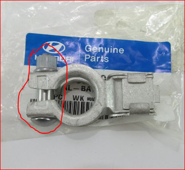

I have attached two additional pictures as well as your two as to what you are missing. On the positive clamp a nut is missing (circled in red). On the negative clamp the nut and bolt the tightens the connection is missing. Your local auto parts stores should have the replacements. A Hyundai dealership definitely will but will be a little more expensive. Hope this helps and feel free to ask any other questions if needed. Thanks for using 2CarPros.
