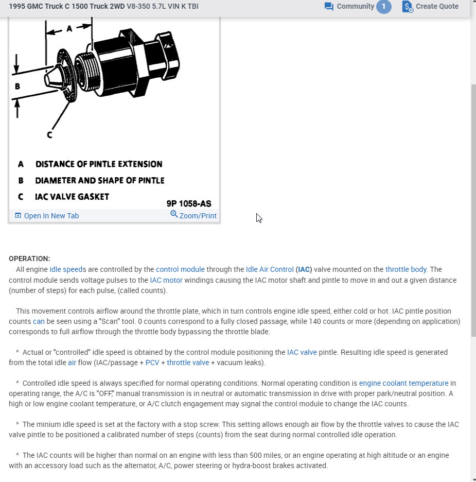

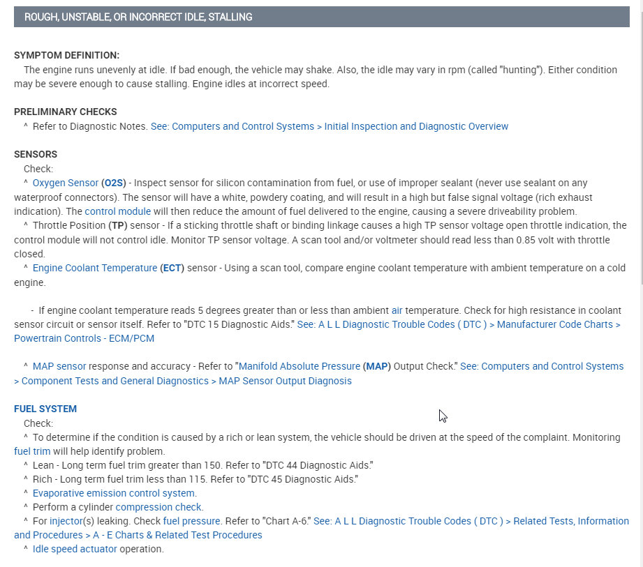

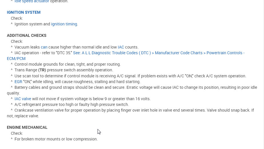

When did this misfire start? Was it after the throttle body spacer? Also, what is the truck idling at? If you added a spacer, you may need to reset your IAC.
Lastly do you have a check engine light? How do you know this is a misfire and not a vacuum leak/rough idle? Do we know which cylinder is misfiring?
Here is a guide that goes over misfires at idle. Attached is a bunch of info about IAC and testing for rough or unstable idle.
https://www.2carpros.com/articles/engine-vibration-at-idle
Let me know what you find and we can go from there. Thanks
