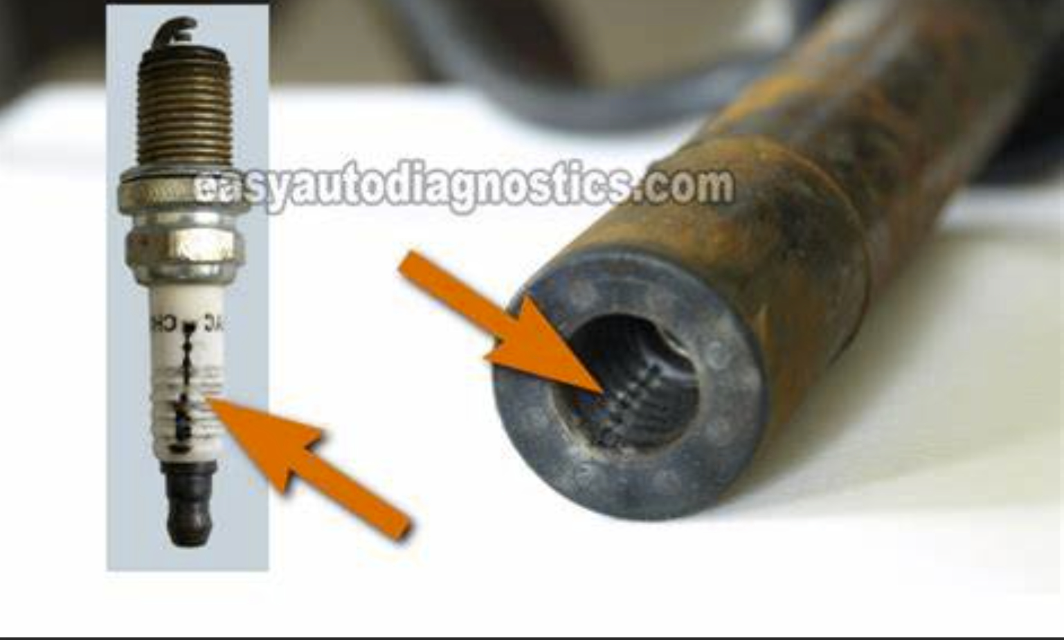

While you have the coils off take a look at them for signs of something called carbon tracking. (I have added a picture as an example) If you see it therefore your cylinders are misfiring. It’s not that likely but remember we are eliminating possibilities, so we want to check it and rule it out.
Electricity is always going to go for the shortest path to ground. Which should be provided through the tip of the plug, but if not, it will find a new direction. Some causes of this could be the plug has excessive resistance or a worn-out plug boot.

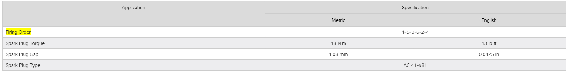

I always recommend using OEM plugs, in your case A/C-Delco is going to be perfect. Go to the dealer and give them your 17-digit VIN so that they can find exactly what goes in your vehicle. This will save headaches and problems down the road. The other good thing is they come pre-gapped.
*However, just because a spark plug is pre-gapped, don’t assume it is correct, always check. *
It is always good practice to check with a feeler gauge. I have included a picture of one as well as the spec for the gap. It should have a light drag, not too much, when you check the gap. Do not use the circular gap tools as they will damage the tip of the plug.
Spark plugs should be torqued. The cylinder heads they screw into are aluminum and just a little over tightening can stretch the threads for the spark plug holes.
However, everyone doesn’t have a torque wrench, so I advise if you don’t to use a 3/8” ratchet with just a regular 7” or so handle. Don’t use anything long. Then gently snug them up with that. You should be able to feel when you get to the right spot. If it gets loose again, then you went too far.
