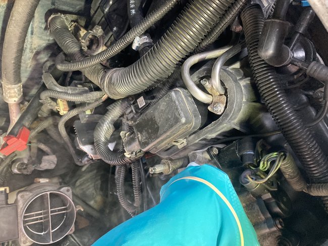

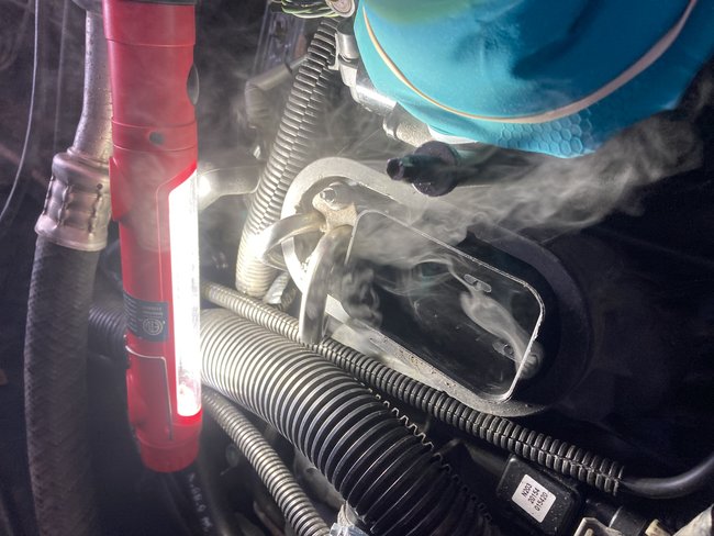

So may next test was to find that vacuum leak. I did a smoke test through the throttle body and found it leak in only one spot. The injector connector. I also noticed that the connector would not go down completely so the side taps would make.
I stopped at that point because i’m wondering if i should take the whole upper intake back off or should i try and pull the injector body up with something like vise grips.
When i installed this i put lube on the rubber seal around the body and thought the upper intake was pushed down enough but i was wrong.

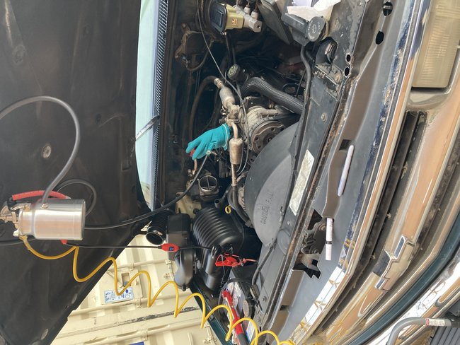

Joe,
If this goes right picture 1 is showing the main injector connection. Pictures 2 and 3 shows the main injector connection removed and the smoke around where. The upper intake and the new spider connects. This is where there is a rubber oval gasket which I lubed to help the two parts come together.
The scan tool stated again a misfire but did not state cylinder 1.
I used carburetor cleaner days ago with someone else present and we did not hear any difference, but I did not do it around the area in the pictures.

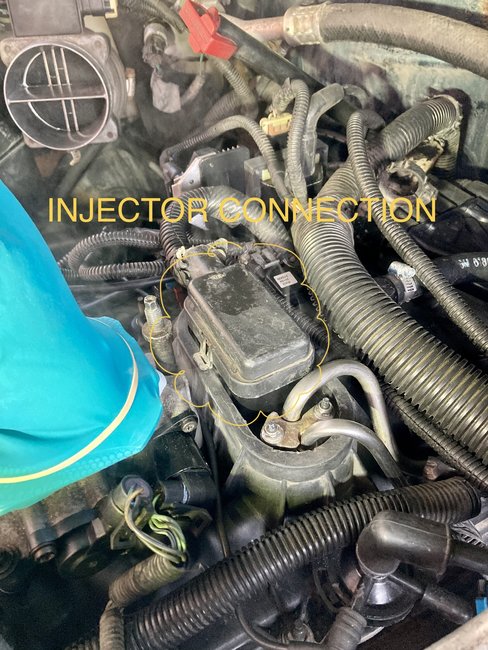

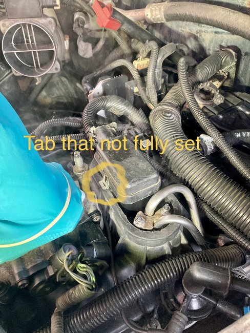

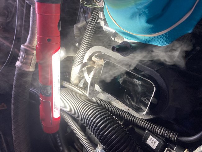

Joe,
Couple more pictures marked up.

I did. Sorry for the delay. Honestly, I would remove the intake again so you can confirm what is causing the leak. If you try to pull it out without removing the intake, you may miss something. It looks like a pretty big leak. That could certainly cause an idle issue.
