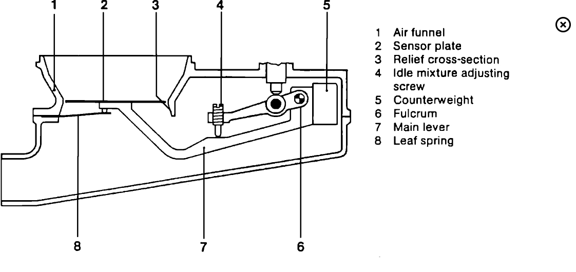

Steve W, some good news, the leakage problem got much better. Mechanic put O2 sensor in tailpipe and it is running lean, 18 to 1. Propane was then hooked up to intake manifold and it smoothed out. So we are now trying to remove the airflow meter but everything is rusted.
Aug 24, 2017 at 10:13 AM
  • 55,395 POSTS
MAF sensors can cause a bunch of troubles.
Here is a guide that can help you see what you are in for when changing the sensor out:
https://www.2carpros.com/articles/how-to-replace-a-mass-air-flow-sensor-maf
Here is what it will be like on your car (below):
Aug 25, 2017 at 5:48 AM
STEVE W.
  • 15,344 POSTS
Rust is such fun. I buy PBlaster and Kroil in case lots.
Setting that long could cause a list of problems. MAF could be damaged. Vacuum lines dry rot, gaskets crack. Adding extra fuel could be a sign that the fuel pump has an issue. Take the propane and run it around the engine near the vacuum lines and intake and see if you get a sudden change in the engines rpm's. If you do you have a leak nearby.
