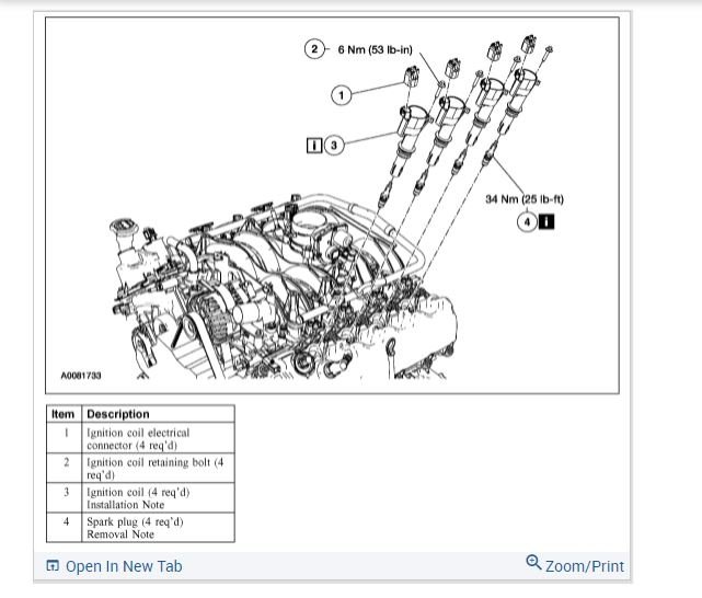

I replaced the plugs and boots, checked ohms on coil packs because of the misfire and it runs better with no problems for several days then it starts again. It seemed to actup more on humid wet days but today was cool and dry. I have no check engine codes. It acts up more at the beginning of the drive then runs great for the rest of the drive. Looking for suggestions. Thanks

I would start with the coils. An ohm test is not accurate to see if one is breaking down under a load. The only way to accurately test the coils is with scope to watch the spikes when under a load.
You have already done the plugs and boots which are the most common.
start there and check back with us for the results. Let us know if you have any other questions.

If the misfires are random and you have an advance scan tool go to mode6 and look up test ID 56. The cylinders will be 01 for cylinder 1 02 for cylinder 2 etc. Look through all of them. The one showing a high count will be the one causing the problem. Most likely the coil but you could have a bad injector as well. The high count cylinder swap the coil to another cylinder and reset the codes even if there is none. Road test to get it to misfire and go back to mode6. If the high count follows the coil you moved that is the bad coil. If no change do the same with the injector. If it follows bad injector. If no change then you have a mechanical fault like sticky valves.

Hi, just a fixed update, when I put the new plugs in, I checked ohms on each coil and all but 1 was at 6 ohms and one a 5 so I put that one in an easy spot and put a new one in and problem fixed. Thanks for all the help. Phil
