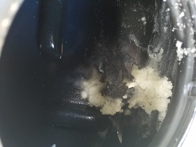

going to throw this at ya my 1999 Dodge Grand Caravan started ro miss and pop through the Manifold after getting gas at 7-11 we have replaced so many parts still nothing - thinking there was water in the fuel tank my husband dropped it while waiting for me to go get fuel pump #2 and this is what he found either it is salt or sugar or sand he said it was sweet yes he tasted it hopefully once we put it back together it will be better Never would have guessed it Good Luck

what was fuel pressure reading?
May 28, 2017 at 9:46 AM
GINA SIMMONDS
Fuel Pressure was reading 50 should have been 53+ new fuel pump is reading 53 cleaning rhe fuel injectors and adding new fuel
May 28, 2017 at 10:22 AM
HMAC300
  • 48,601 POSTS
w pressure will give a misfire
