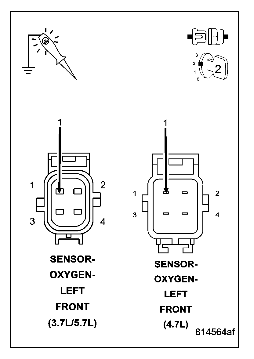

Am a car dealer, bought this truck and had ERG code cleaned out even though it is clean, no codes since then, but still misfires with p0032 only, at idle the misfire is worse once you touch the gas pedal and rev the rpm just a bit it smooths out, checked one plug and it looks good, no other codes, while driving it hesitates a lot and stalls sometimes when making a turn, cranks from the first time.

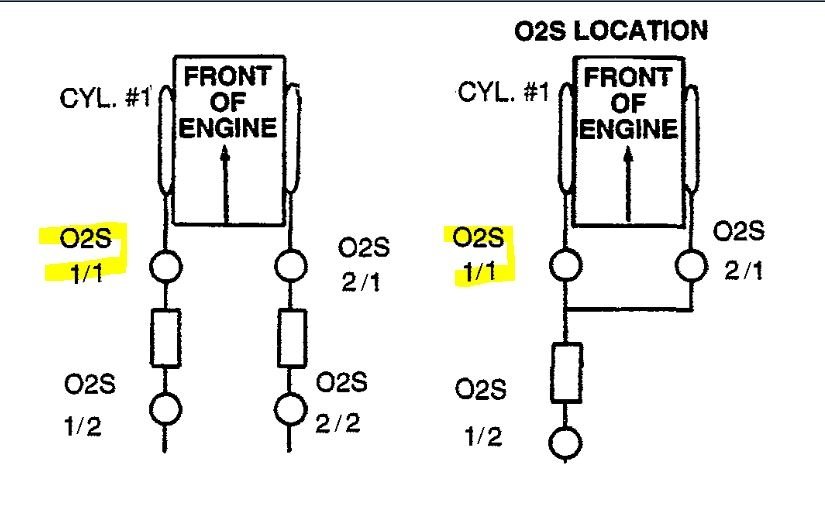

No this is an 2005 Dodge Ram 1500 v8 with 5.7. no, i have not yet changed the oxygen sensor, which is it the driver side before the catalytic at the exhaust manifold?
Jul 26, 2019 at 12:12 PM
  • 110,240 POSTS
Welcome back:
Sorry. I have no idea why I was thinking this was a van. Ugh!!! Anyway, yes, left side, sensor one. If you need a diagnostic flow chart, let me know. It does require use of testing equipment and a good understanding of an electrical system.
See attached picture for sensor locations.
Let me know what you find.
Jul 26, 2019 at 2:06 PM

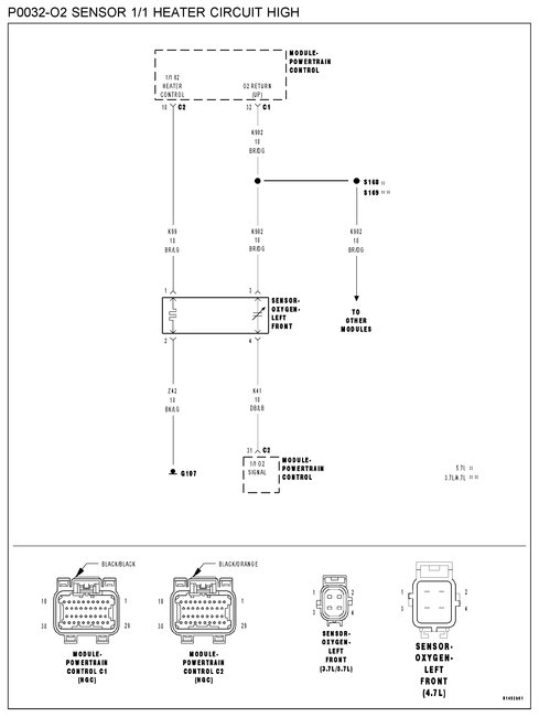

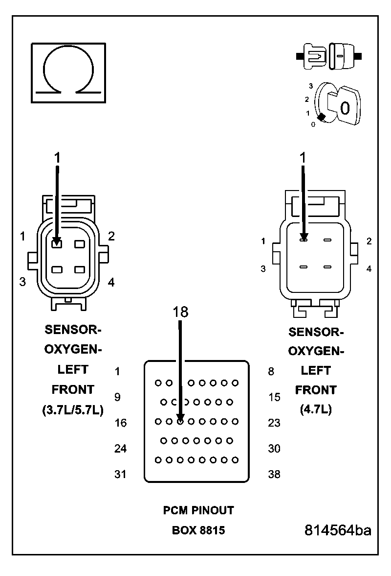

No problem. Here is the flow chart related to the P0032. The attached pictures correlate with the directions.
______________________
P0032
Vehicle ALL Diagnostic Trouble Codes ( DTC ) Testing and Inspection P Code Charts P0032
P0032
P0032-O2 SENSOR 1/1 HEATER CIRCUIT HIGH
P0032 - O2 1/1 Heater Circuit High

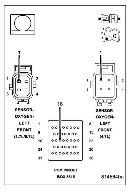

2. O2 HEATER ELEMENT
Turn the ignition off.
NOTE: Allow the O2 Sensor to cool down to room temperature.
Disconnect the 1/1 O2 Sensor harness connector.
Measure the resistance across the O2 Sensor Heater element between the O2 Heater Control terminal and the O2 Heater ground terminal at the component.
NOTE: O2 Heater Element resistance values should be measured at 70° F (21.1° C). The resistance value will vary with different temperature values.
Q: Is the O2 Sensor Heater Element resistance between 2.0 and 30.0 ohms?
YES: Go To 3
NO: Replace the O2 Sensor. Perform the POWERTRAIN VERIFICATION TEST. See: A L L Diagnostic Trouble Codes ( DTC ) > Verification Tests > Powertrain Verification Test
3. (K99) O2 1/1 HEATER CONTROL CIRCUIT
pic 2
Ignition on, engine not running.
With a scan tool, actuate the O2 1/1 Heater Test with the Sensor harness connector still disconnected.
Using a 12-volt test light connected to ground, probe the (K99) O2 1/1 Heater Control circuit in the O2 Sensor harness connector.
Q: Does the test light illuminate brightly and flash on and off during the actuation?
YES: Go To 4
NO: Go To 5

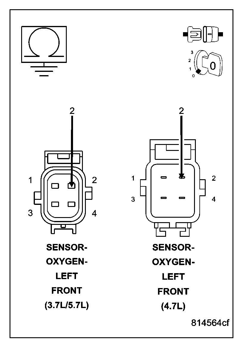

4. (Z42) O2 HEATER GROUND CIRCUIT OPEN
Pic 3
Measure the resistance between an engine ground and the (Z42) O2 1/1 Heater ground circuit in the O2 Sensor harness connector.
Q: Is the resistance below 5.0 ohms?
YES: Replace the O2 Sensor. Perform the POWERTRAIN VERIFICATION TEST. See: A L L Diagnostic Trouble Codes ( DTC ) > Verification Tests > Powertrain Verification Test
NO: Repair the open in the (Z42) O2 1/1 Heater ground circuit. Perform the POWERTRAIN VERIFICATION TEST. See: A L L Diagnostic Trouble Codes ( DTC ) > Verification Tests > Powertrain Verification Test

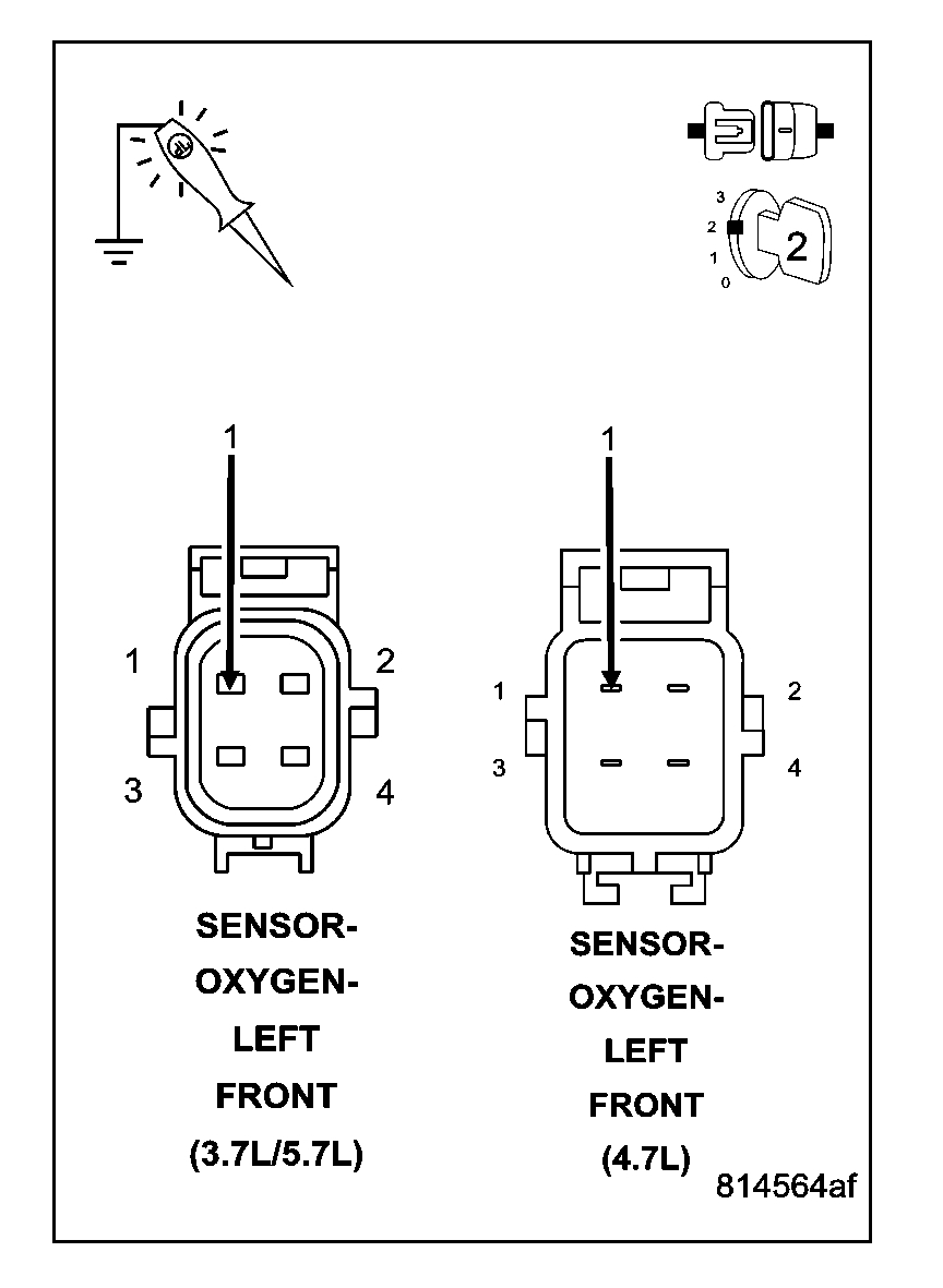

5. (K99) O2 1/1 HEATER CONTROL CIRCUIT SHORTED TO BATTERY VOLTAGE
pic 4
Disconnect the C2 PCM harness connector.
Q: Does the test light illuminate brightly?
YES: Repair the short to battery voltage in the (K99) O2 1/1 Heater Control circuit. Perform the POWERTRAIN VERIFICATION TEST. See: A L L Diagnostic Trouble Codes ( DTC ) > Verification Tests > Powertrain Verification Test
NO: Go To 6

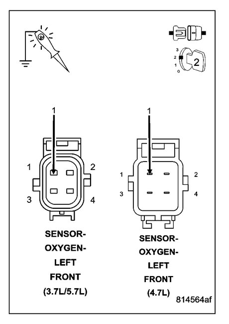

6. (K99) O2 1/1 HEATER CONTROL CIRCUIT OPEN
pic 5
CAUTION: Do not probe the PCM harness connectors. Probing the PCM harness connectors will damage the PCM terminals resulting in poor terminal to pin connection. Install Miller Special Tool #8815 to perform diagnosis.
Measure the resistance of the (K99) O2 1/1 Heater Control circuit from the O2 Sensor harness connector to the appropriate terminal of special tool #8815.
YES: Go To 7
NO: Repair the open in the (K99) O2 1/1 Heater Control circuit. Perform the POWERTRAIN VERIFICATION TEST. See: A L L Diagnostic Trouble Codes ( DTC ) > Verification Tests > Powertrain Verification Test
