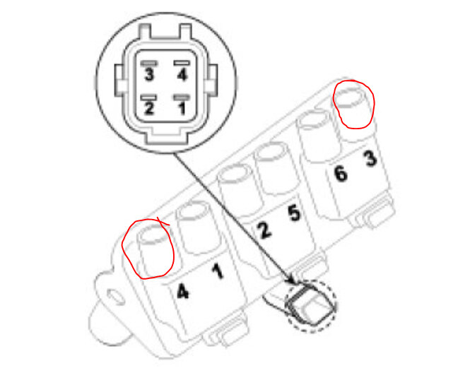

If the light is flashing, that indicates a misfire is occurring. The first thing I suggest is to confirm you have the spark plug wires in the correct positions.
I attached a pic below showing the coils and identifying what cylinder each wire goes to.

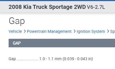

Next, if the wires are correct, remove cylinder 3 and 4 spark plugs and make sure the gap is set properly. Also, make sure dirt didn't get on the electrode when you were installing them.
(See pic 2)
