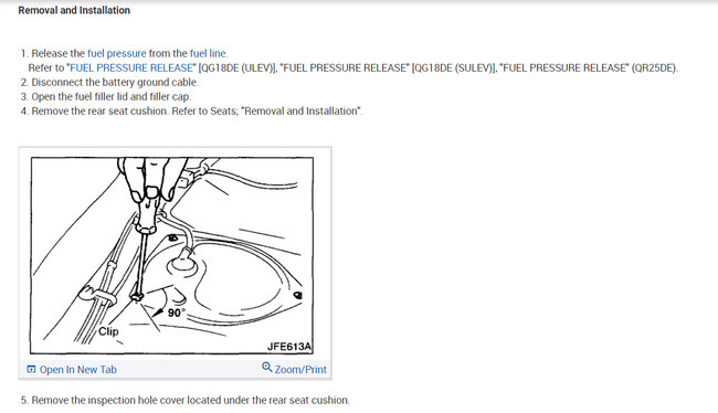

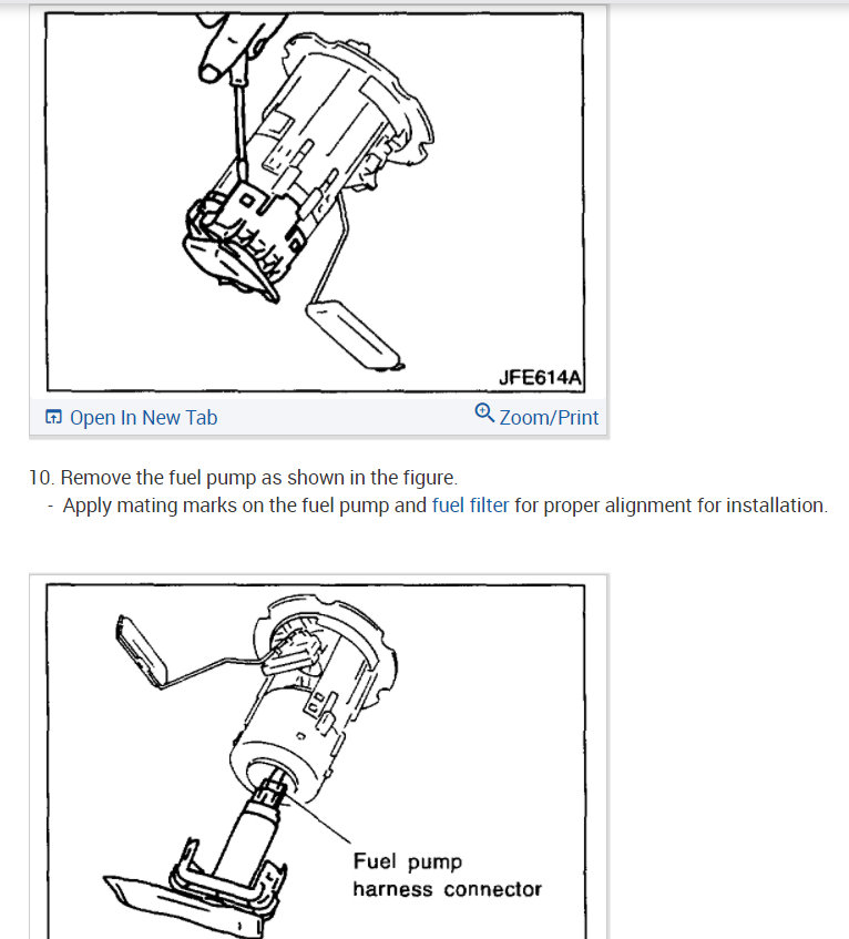

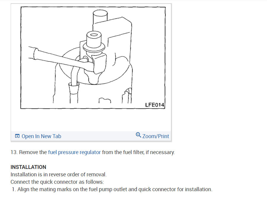

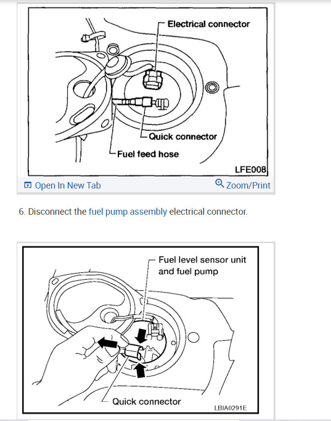

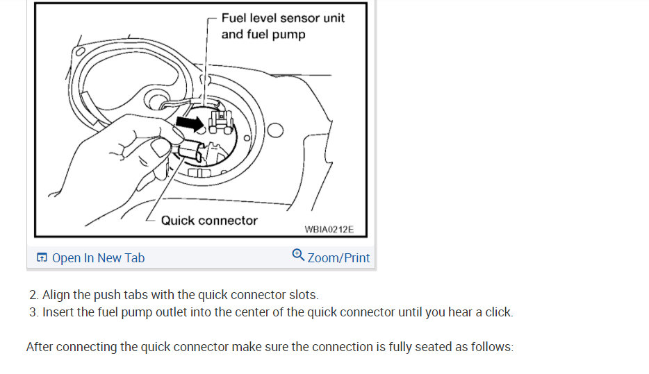

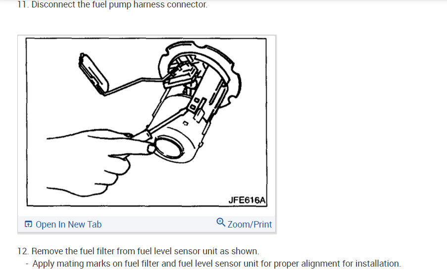

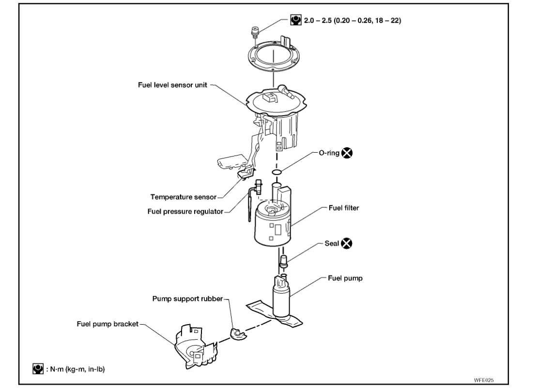

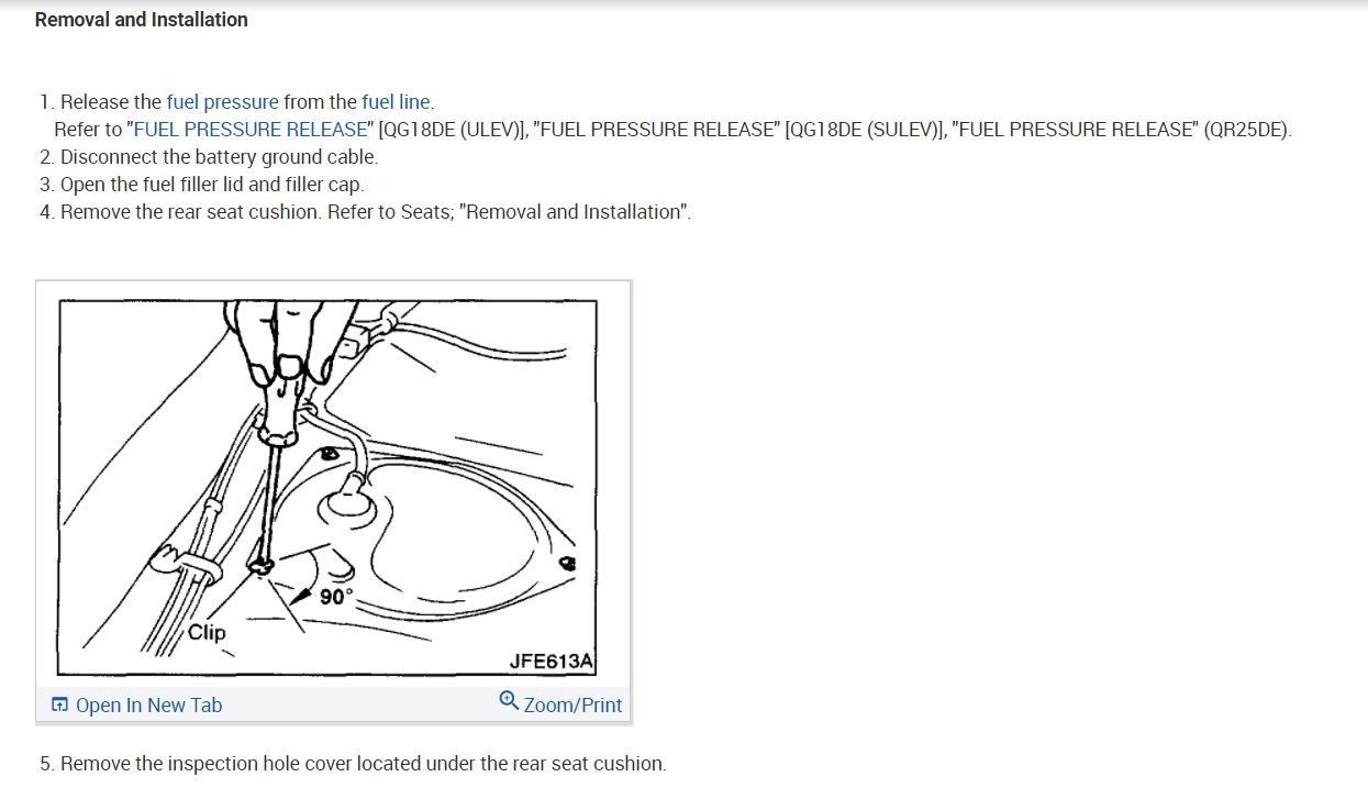

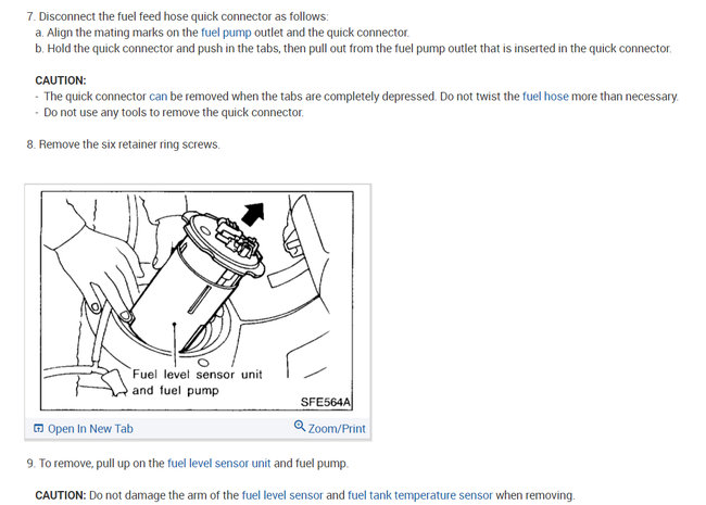

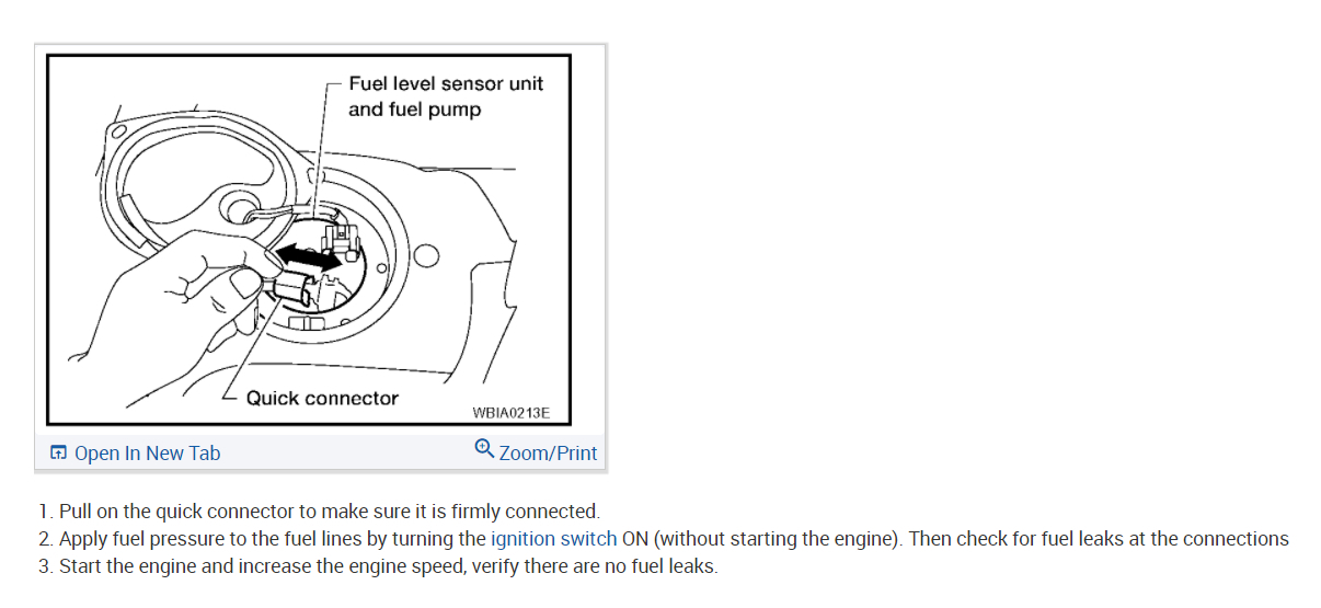

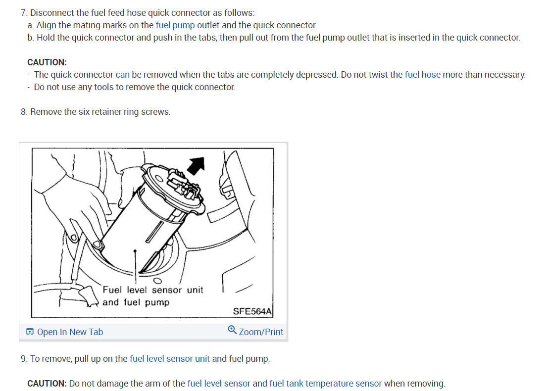

The one thing they did not do that I would have done is a fuel pressure test to be sure the fuel pump is working correctly. That is the most common reason for the misfire codes.
Fuel Pressure
Fuel pressure at idle .................... Approximately 350 kPa (3.57 kg/sq.cm., 51 psi)
I attached the procedure for you below if it is the fuel pump that is the failure.
