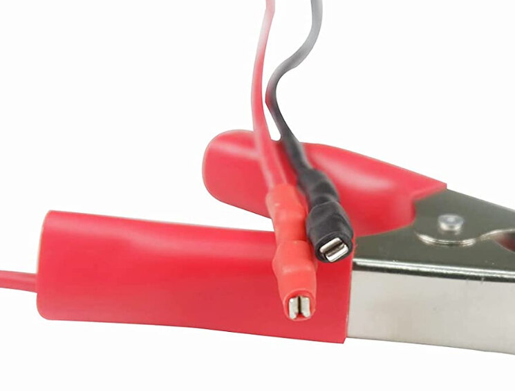

Below is the Fuel injector pulse tool, it hooks up your car battery and allows you to pulse the fuel injector a certain amount just like the engine computer does, when you have a fuel pressure gauge hooked up to the fuel rail, you will monitor how much the pressure drop is for each fuel injector.

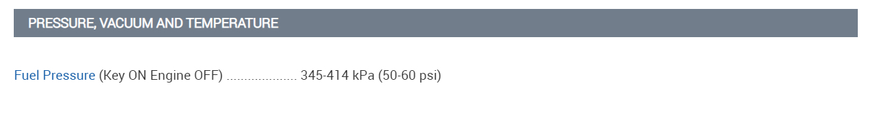

Turn the key to the on position, not engine running. This will prime the fuel system up to operating pressure, then pulse the injector, write down how low the pressure went. Then move on to the next fuel injector and do the exact same thing.
So, for example, key "on" your pressure will be 50 to 60 PSI, pulse the tool and the pressure will drop around 15 to 20 PSI. Then write down the current pressure (35 PSI or whatever it is). Hook up to the next injector, key "on", pulse the tool. write down the results and so on. If any fuel injectors are clogged or allowing too much fuel, there will be a difference in your test results, pinpointing the issue. After you do all four cylinders start the vehicle to clear out all the fuel before retesting.
