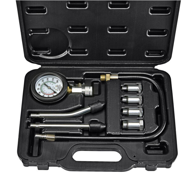

I would start with the compression test. If you don't already have a compression tester you can rent one at your local auto parts store.
Here is an article on how to perform this test:
Do the test once and record all your readings. Then put a capful of oil in a cylinder and test it again, one cylinder at a time. If the readings are higher then you may have bad rings. If there is little to no change it may be the valve seats which would let oil in from the valvetrain.
I found one on Harbour Freights website for $30.
Here is the link:
https://www.harborfreight.com/compression-test-kit-8-piece-62638.html?utm_source=bing&utm_medium=cpc&utm_campaign=425671834&campaignid=425671834&utm_content=1154488236059904&adsetid=1154488236059904&product=62638&store=639&msclkid=ee13bd209b9c18a97115d957eb53ef25
While renting one is easier, they usually get banged around a lot which could give you false readings so you might want to consider getting a new one.

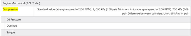

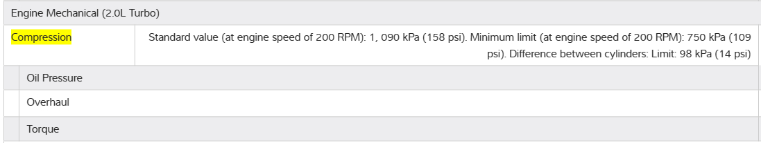

I am also adding the compression specs for you.
