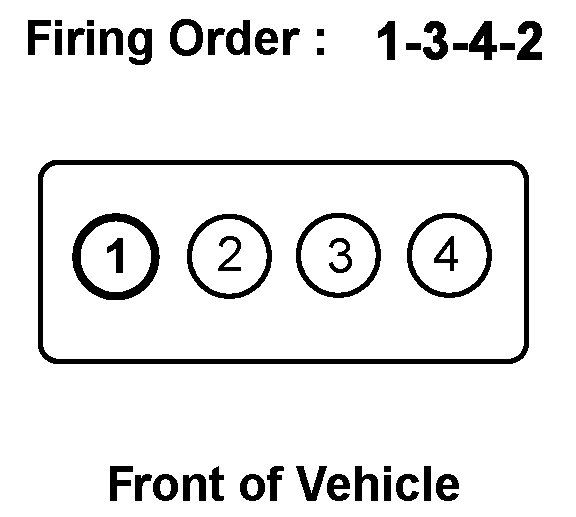

Where is cylinder two located? it is causing misfire.

I have attached a picture of the firing order and cylinder placement. Check out the diagrams (Below). Please let us know if you need anything else to get the problem fixed. Hope it helps.
