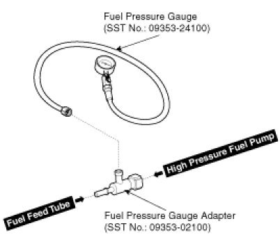

2. Install the Special Service Tool (SST).
(1)Disconnect the fuel feed tube from the delivery pipe.
CAUTION:
There may be some residual pressure even after "Release Residual Pressure in Fuel Line" work, so cover the hose connection with a shop towel to prevent residual fuel from spilling out before disconnecting any fuel connection.
(2)Install the special service tool for measuring the fuel pressure in between the fuel feed tube and the fuel delivery pipe .

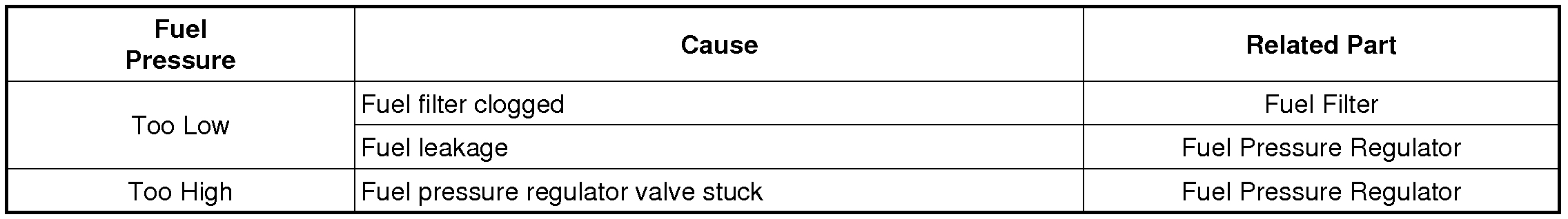

4. Measure Fuel Pressure.
(1)Start the engine and measure the fuel pressure at idle.
Fuel Pressure:
480 - 500 kPa (4.9 - 5.1 kgf/cm2, 69.6 - 72.5 psi)
NOTE:
If the fuel pressure differs from the standard value, repair or replace the related part .

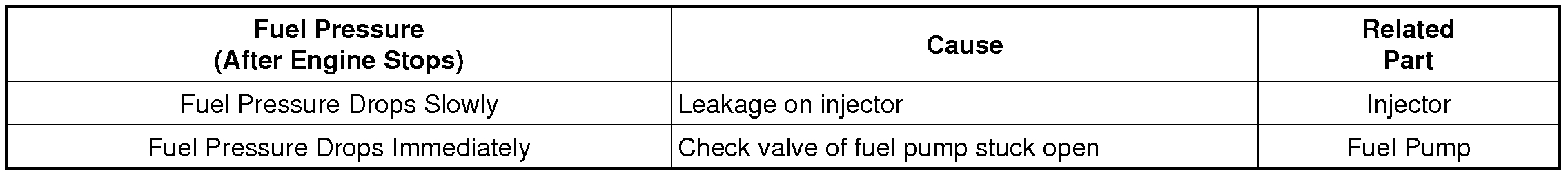

(2)Stop the engine, and then check for the change in the fuel pressure gauge reading.
Standard Value:The gauge reading should hold for about 5 minutes after the engine stops
NOTE:
If the gauge reading should not be held, repair or replace the related part .
