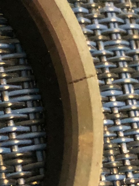

Hey Joe it's Jason. I don't know what happened to my line of questions and answers that we have been communicating back and forth went. But it was about the misfire on cylinder 7 and end result was a tear down top end of motor because of valve seat issue. So hopefully you remember me and I have some results. Looks like they found a couple of cracked seats, but definitely wasn't what the dealer said about hearing air coming through the intake. The cracks were fine, no burnt valve. Anyway have you ever heard of a valve job where they don't have to lap the valves, the guy said that the machine he has does such a precise job that he doesn't have to lap the valves. I just thought it was odd. Take care and talk to you soon. :)

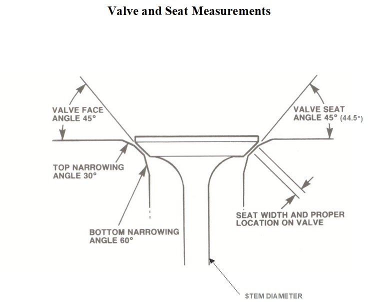

Also be aware lapping is more of a small engine thing. Automotive engines are machined much more precisely. We didn't even have lapping compound at the dealership. When the valve seats are ground, or in this case replaced, the width of that seat is narrower than what is specified by the manufacturer. The pounding action of the valve face is going to hammer out the seat and make it wider over time, and it will stop growing wider just when it reaches the specification. At that point the pressure from the valve spring will be spread out over such a large area that the seat won't pound out any wider.
To say that a different way, you may start out with a valve seat that's 1/16" wide, then if you tear that engine down again a few thousand miles later, that same seat will be 3/32" wide.
The seat and face are also ground at slightly different angles, usually half a degree different. That causes the valve's face to only contact a very thin ring on the seat, at first. Part of the reason is if a small chip of carbon gets stuck in there, it will crack in half and be easier to expel, rather that getting trapped between the seat and face. They usually recommend a break-in period of relatively mild driving for that seat to hammer out and make full contact. One of the functions of that seat contact area is to transfer heat from the valve head to the cylinder head. That is very inefficient at first due to that angle difference between the seat and face. We want to avoid running the engine hotter than necessary at first because the valve could overheat and start to burn away. Even if you were to lap the valve, you'd only be grinding a small portion of that thin ring of contact. The valve is going to make its own sweet spot and seal properly over a few thousand miles.
This is one of my "In-Class Notes Pages" that shows that angle difference.
