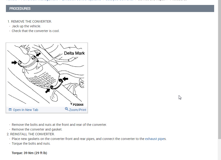

Thanks for the additional info. This would actually support what Danny is suggesting that you could have a plugged exhaust. What appears to be happening is when the RPM is raised, it is not able to move enough air through the exhaust due to the restriction. Then the restriction is causing a misfire and the raw fuel is going through into the converter where it is burning in the converter causing the higher outlet temp. I would suggest removing the up and down stream o2 sensors and drive the vehicle. It is going to be loud but should not misfire any more. If it does not at 2,500 RPM's then you need to replace the converters.
https://www.2carpros.com/articles/exhaust-system-removal
Also, here is the process below of the converter from the manual. Let us know what you find. Thanks
