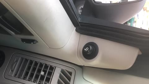

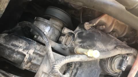

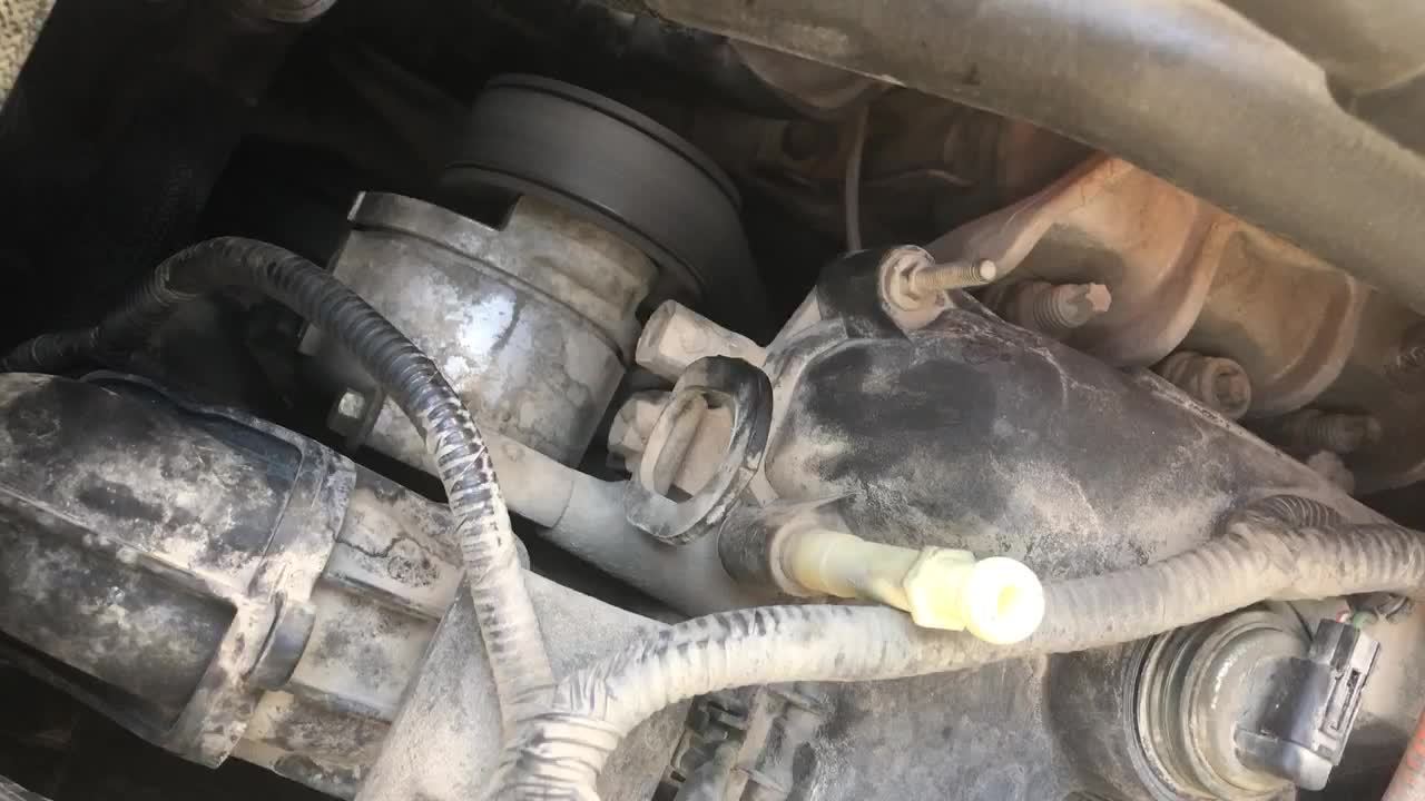

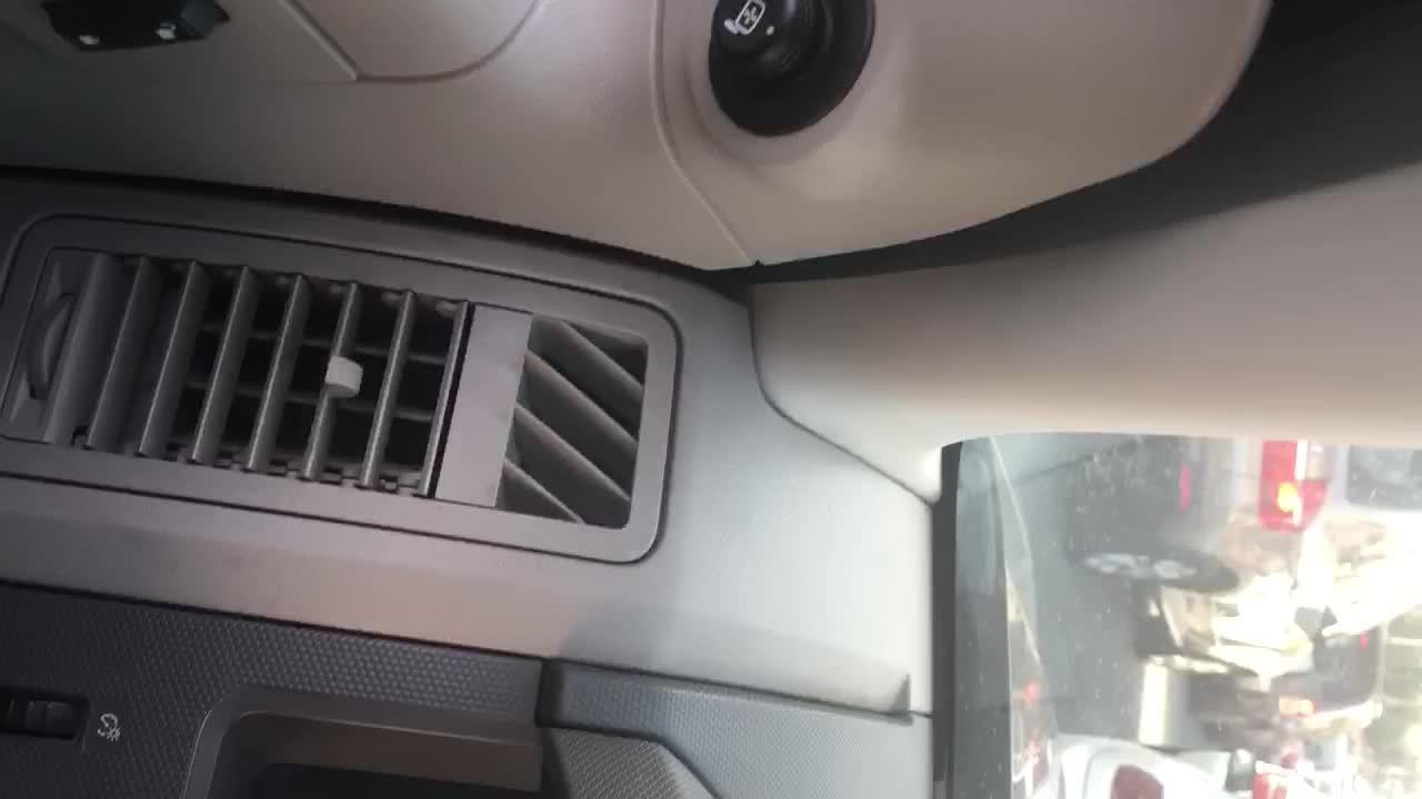

Hi, my problem not in performance of car, it is the strange metallic click like spring click from the engine, can't hear it in first 10 minute drive, but after that I noticed it when I accelerate after press on gas pedal once click and the other click follow it within seconds when I release gas pedal. In other words at start of rpm rise and when rpm fall, it is (first click. Seconds. Second click), and this episodes continue with each acceleration, this noise have been noticed for 8 years, some mechanics said this is normal, but I am not sure this is normal. I accept the A/C clutch click

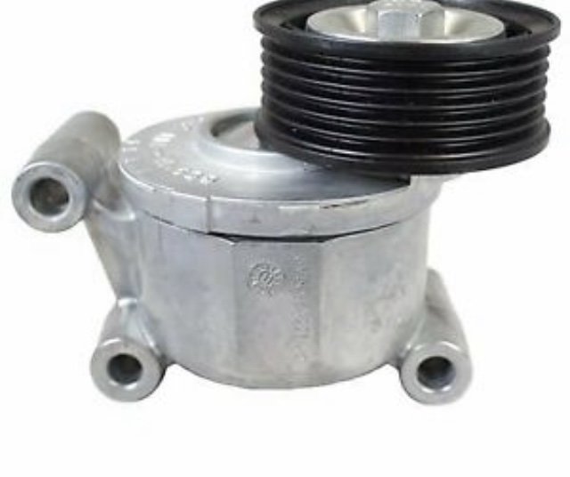

But why click while A/C is off? This is non sense. I open hood and tried to locate the source of noise, I think it came from tensioner area. What is your opinion? Is this sound can be from tensioner? As I said this noise is heard for the last 8 years and really want solve this issue. I can hear it while driving, it is clear click. I hope you can help localize source of this irritating clicks.
Thanks

Can you upload a video of the noise so I can hear what you hear?

That chirp is a bearing. I would remove the belts and start it up and see if it is there.

First, you need to do what I suggested. If you remove the belt and the noise stops, then it could be one of several bearings. Alternator, tensioner, pulley, A/C bearing among the few.
If the noise is still there, then it could be a water pump.
Do the test I suggested.

Others told me I have to change tensioner as it shakes a little when the A/C clutch engage which make sound louder.
