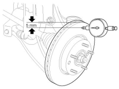

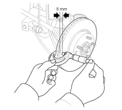

I hear a metal scraping sound only when going very slow and when braking while going very slow. I do not hear scraping noise while driving or breaking at a higher speed.
Oct 29, 2018 at 3:33 AM
  • 110,244 POSTS
Chances are it is the front brakes in need of replacement. Today's cars mostly have steel sensors mounted on the backing plate.of the pads that are designed to indicate when the pads are ready to be replaced. If the sound changes when you apply the brakes, that is my first suspect.

Front Brake Disc Thickness Check
1. Check the brake pads for wear and fade.
2. Check the brake disc for damage and cracks.
3. Remove all rust and contamination from the surface, and measure the disc thickness at 8 points, at least, of same distance (5mm) from the brake disc outer circle.
Front brake disc thickness
Standard : 23 mm (0.906 in)
Service Limit : 21 mm (0.827 in)
Deviation: Less than 0.005 mm (0.0002 in)
4. If wear exceeds the limit, replace the discs and pad assembly left and right of the vehicle.

Front Brake Disc Runout Check
1. Place a dial gauge about 5mm (0.2 in.) from the outer circumference of the brake disc, and measure the runout of the disc.
Brake disc runout
Limit: 0.04 mm (0.0016 in.) or less (new one)
2. If the runout of the brake disc exceeds the limit specification, replace the disc, and then measure the runout again.
3. If the runout does not exceed the limit specification, install the brake disc after turning it 180° and then check the runout of the brake disc again.
4. If the runout cannot be corrected by changing the position of the brake disc, replace the brake disc.
