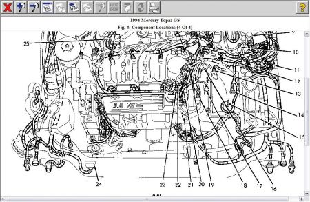

  • 75,992 POSTS
That's why were not getting anywhere the temp. switch is for the gauge, the CTS is for the fan thru PCM and relay. Look below no.23 CTS
https://images.2carpros.com/forum/automotive_pictures/12900_cts_1.jpg
and get back to me, we wasted valuable time
Oct 29, 2007 at 7:09 PM

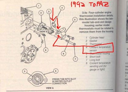

BUMBLEDOR
  • 6 POSTS
I couldn't quite make out what item you ment by the drawing, I even got a copy of it to enlarge, and still could not make it out. THIS is what I have checked out based on the information posted here so far.
https://images.2carpros.com/forum/automotive_pictures/110024_n1_1.jpg
Oct 30, 2007 at 6:45 PM
