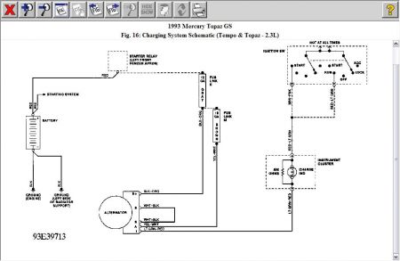

1993 Mercury Topaz Alternator won't charge battery.
1993 MERCURY TOPAZ
150,000 MILES • 4 CYL • 2WD • AUTOMATIC
RRPLUTA02
I took the alternator out and had it checked and it pass with flying colors. I put it back in and it won't charge the battery. The battery is brand new. I was told there was an inline fuse in one of the wires coming off the alternator. My question is: Does anyone know which wire has the in line fuse and if I cound possibly run a jumper wire directly yo the Battery to by pass the fuse?
Dec 9, 2007 at 1:43 PM
  • CAR REPAIR CONTRIBUTOR
  • 75,992 POSTS
Behind the alternator black and orange wire at B+ has a gray fusible link and the A terminal with the brown fusible link. See below
https://images.2carpros.com/forum/automotive_pictures/12900_alty_4.jpg
