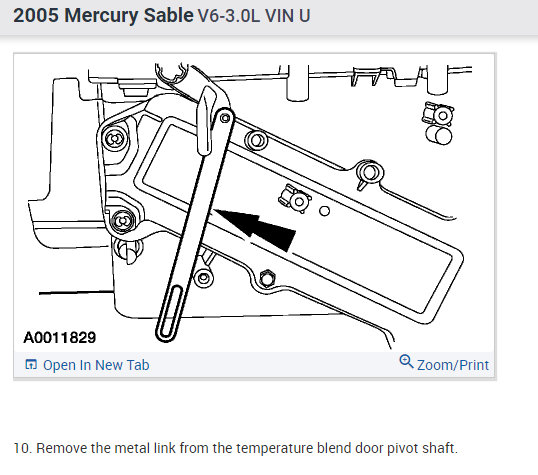

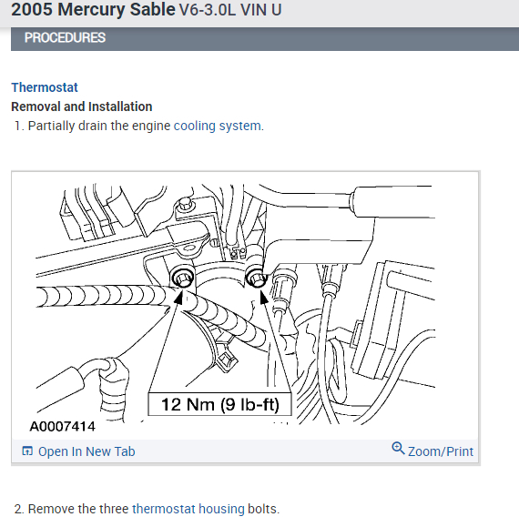

car heater puts out cold air. ac ok but not very cold. Addes coolant, but no help!
Jun 30, 2010 at 3:00 PM
SQM
  • CAR REPAIR CONTRIBUTOR
  • 6,383 POSTS

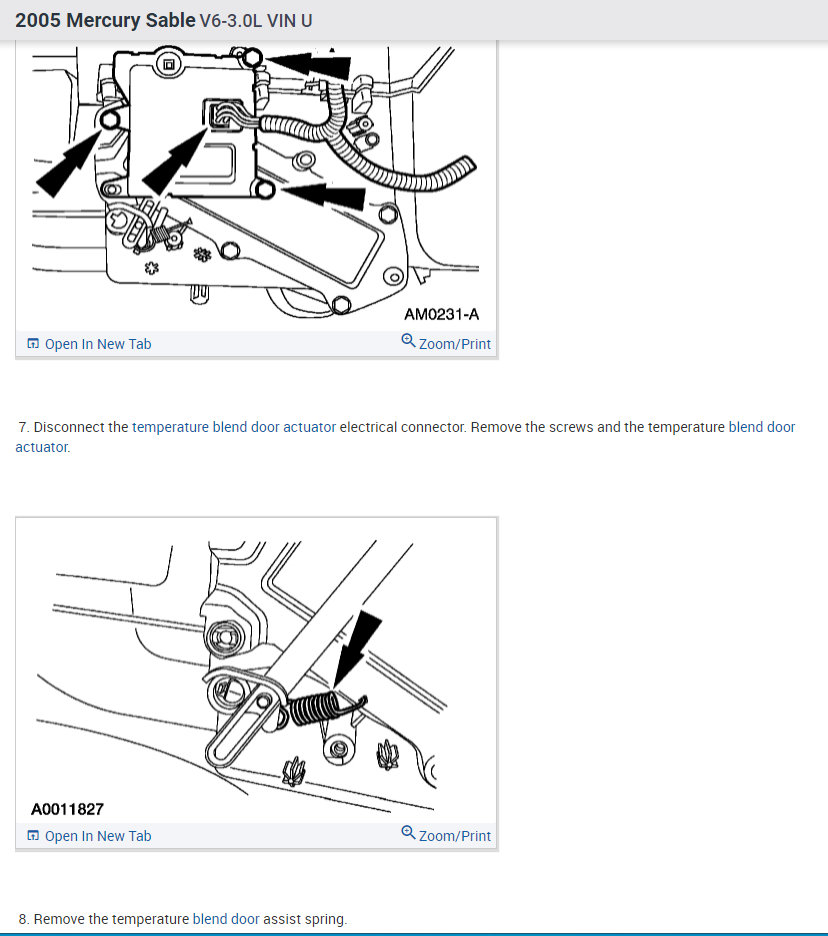

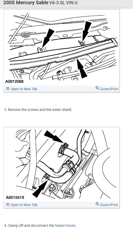

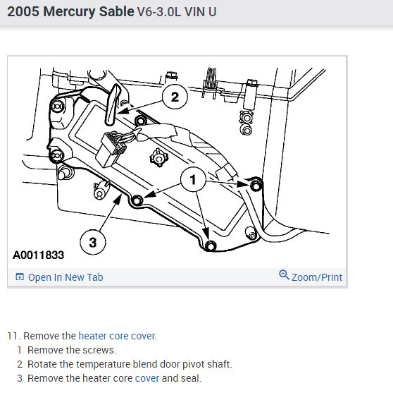

A heater can blow cold air for few reasons.
It can happened is the coolant does not flow thru the heater core properly due to any type of restriction in the pipes or a clog in the heater core.
Sometimes flushing the system can improve the heater performance.
https://www.2carpros.com/articles/how-a-car-heater-works

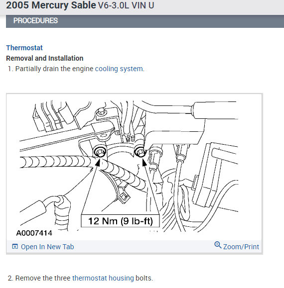

Also you might get cold air if the thermostat is stuck open. When this happens the engine does not reach its operating temperature and the air for the heater comes out cool.
Check to see if the engine runs cooler than usual. That could be a sign of a stuck open thermostat.
