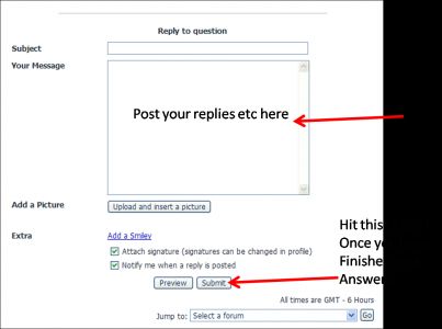

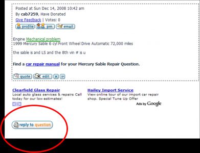

It appears that you are reposting each time instead of doing the reply. I have attached a pic for you. Once you have initially posted a question, all you have to do is select the button at the bottom that I have circled in red. . ...then go into the are on the next pic and then select the submit button once you have answered. Then it goes back to the moderator that you are working with.
Also, thank you very much for the car info. . ...but I still need to know what part are you working on that you need the torque for.
https://www.2carpros.com/forum/automotive_pictures/248015_1_112.jpg
https://www.2carpros.com/forum/automotive_pictures/248015_2_73.jpg

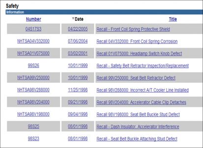

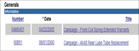

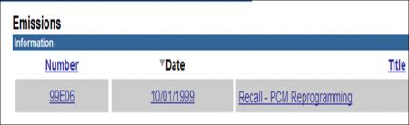

Also, looks like you may have some recalls on your vehicle. The dealer may fix these for free. Please contact the dealer service department, give them the VIN number of your car and have them check on these to see if they apply to you. I attached them last.

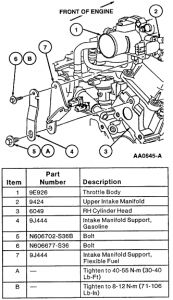

https://www.2carpros.com/forum/automotive_pictures/248015_Upper_1_1.jpg
Remove retaining nut and bolts for upper generator brace and remove brace.
Remove engine control sensor wiring bracket from throttle body retaining stud bolt and position engine control sensor wiring out of the way.
On California Gasoline and flexible fuel equipped vehicles, remove intake manifold support from the throttle body and RH cylinder head.
https://www.2carpros.com/forum/automotive_pictures/248015_Upper_2_1.jpg

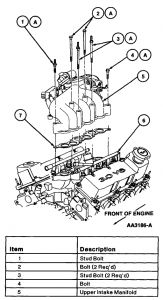

Loosen and remove the upper intake manifold retaining bolts and stud bolts (note location for installation).
Lift and remove upper intake manifold from lower intake manifold.

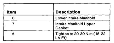

Aligning bolt holes, install upper intake manifold on lower intake manifold. Install stud bolts and retaining bolts. Tighten to 20-30 Nm (15-22 ft. lbs.) .

Install intake manifold support to the throttle body and RH cylinder head. Tighten retaining bolts as shown in the illustration.

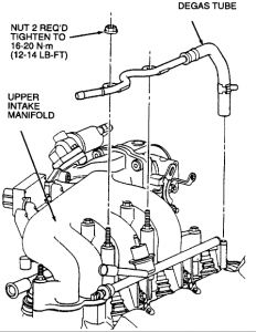

Install degas tube to the upper intake manifold. Tighten retaining nuts to 16-20 Nm (12-14 ft. lbs.).

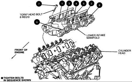

Install fuel injection supply manifold retaining bolts and tighten to 8-12 Nm (71-106 inch lbs.).
https://www.2carpros.com/forum/automotive_pictures/248015_Lower_1_1.jpg

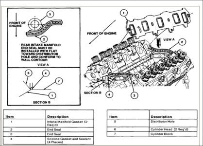

NOTE: Prior to applying sealer, clean sealing surfaces of cylinder block and cylinder head with Metal Surface Cleaner F4AZ-19A536-RA or equivalent meeting Ford specification WSE-M513392-A, to remove all residues that may interfere with the sealer's ability to adhere. Apply a 5-6 mm (1/4-inch) drop of Silicone Gasket and Sealant F7AZ-19554-EA or equivalent meeting Ford specifications WSK-M2G343-A4 to intersection of cylinder block and cylinder head at four corners as shown.
Position intake manifold gasket onto cylinder heads. Align intake manifold gasket locking tabs to provisions on head gaskets as shown.
Install front and rear intake manifold end seals as shown. Secure with retainers.
https://www.2carpros.com/forum/automotive_pictures/248015_Lower_2_1.jpg
Carefully position lower intake manifold, aligning intake manifold bolt holes, to those in cylinder head. Use care to prevent disturbing silicone sealer which can cause sealing voids.
Install bolts No. 1, 2, 3, and 4 and hand-tighten.
Install remaining bolts and tighten in sequence shown in two steps.
Tighten in numerical sequence to 20-30 Nm (15-22 ft. lbs.).
Tighten again in Sequence to 26-32 Nm (20-23 ft. lbs.).

https://www.2carpros.com/forum/automotive_pictures/248015_Recall_1_1.jpg
https://www.2carpros.com/forum/automotive_pictures/248015_Recall_2_1.jpg
https://www.2carpros.com/forum/automotive_pictures/248015_Recall_3_1.jpg
