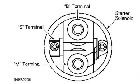

SERVICE WRITER
  • 9,123 POSTS
https://www.2carpros.com/forum/automotive_pictures/30961_sab_1.jpg
Connect your voltmeter positive lead to positive battery terminial. Connect the voltmeter negative lead to "M" terminal on the starter solenoid. Crank engine and observe voltmeter (2 people of course).
IF voltmeter reading is less than .5 volt, then it is getting power and you need the starter.
Saturday, March 29th, 2008 AT 8:29 PM
