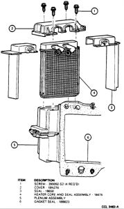

how to replace the heater core in the Grandmarquis
Saturday, January 9th, 2010 AT 8:40 PM
  • 75,992 POSTS
Removal:
1.Remove the plenum assembly. See: Heater Core Case Service and Repair
Heater Core Removal And Installation
https://www.2carpros.com/forum/automotive_pictures/12900_heatercore_1.jpg
2.Remove the four retaining screws from the heater core cover and remove the cover from the plenum assembly.
3.PULL the heater core and seal assembly from the plenum assembly.
Installation:
1.Carefully install heater core and seal assembly into the plenum assembly. Visually check to ensure that core seal is properly positioned.
2.Position the heater core cover and install the four retaining screws.
3.Install the plenum assembly.
