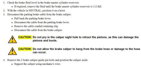

I've replaced brake pads on the front of numerous vehicles, foreign and domestic. Now the rears on my Milan need replacement & I am hesitant inasmuch as it is AWD and the the parking brake is integral to the calipers. Any guidance would help. Tks

https://images.2carpros.com/forum/automotive_pictures/261618_Noname_2700.jpg
https://images.2carpros.com/forum/automotive_pictures/261618_Noname2_877.jpg
