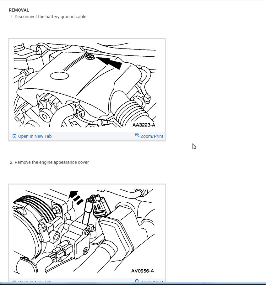

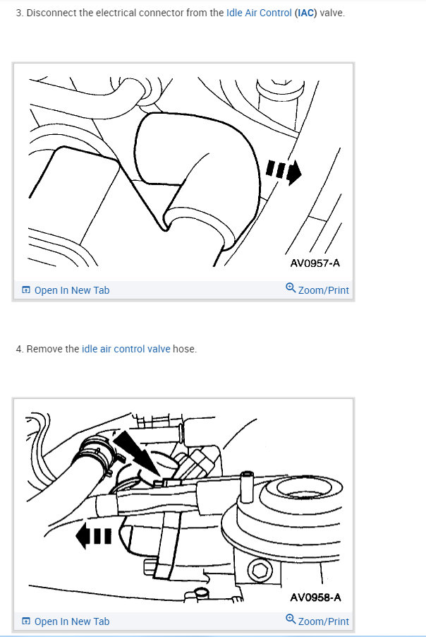

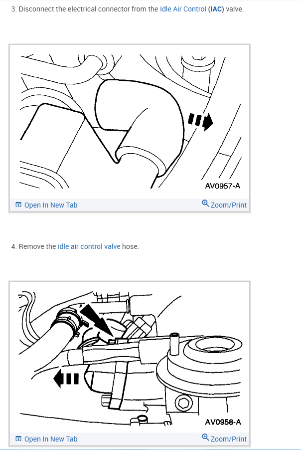

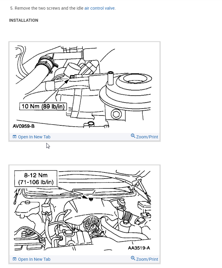

This post was from about 12 years ago so I doubt they will respond but I can assist. I would not recommend trying to clean you IAC this way. It may work for a short time but you can also damage your various sensors that are in the intake because you are just wildly spraying a chemical through your intake.
I attached a guide on how to clean an IAC.
https://www.2carpros.com/articles/idle-air-control-valve-service
Assuming you have the same vehicle listed, here is the process for removing and reinstalling. Let me know if you have questions.
Tuesday, January 7th, 2020 AT 5:43 PM
