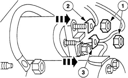

how many bolts are there to take out a the starter I took i out 2 from the where would the others be located because with the 2 i took out it's not coming out and that's what autozones diagram tells me that there's 2 bolts how many are there total and where would they all be located

Disconnect the negative battery cable. Raise the vehicle and support it safely. Label and disconnect the starter cables from the starter. If equipped with starter mounted solenoid, detach the push-on connector from the solenoid. To detach the hard-shell connector from the solenoid S terminal, grasp the plastic shell and pull off; do not pull on the wire. Pull straight off to prevent damage to the connector and S terminal. Remove the starter bolts and the starter. Remove the cables from the starter terminals
https://images.2carpros.com/forum/automotive_pictures/261618_0900c152801e4768_1.jpg
To install: Position the starter to the engine and tighten the mounting bolts to 15-20 ft. lbs. (20-27 Nm). Reconnect the electrical leads. Lower the vehicle. Connect the negative battery cable. thanks for using 2CarPros.com!
