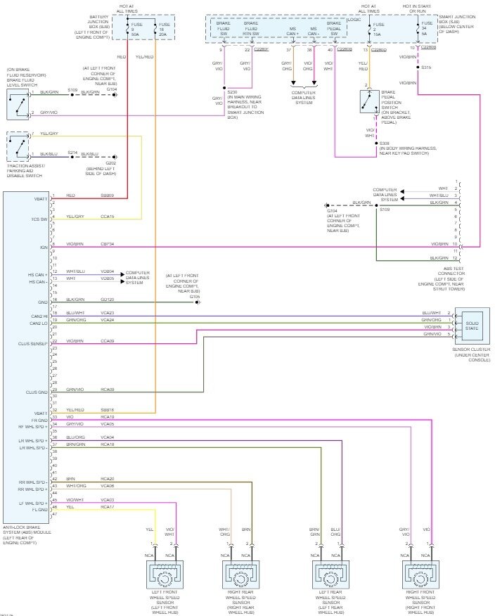

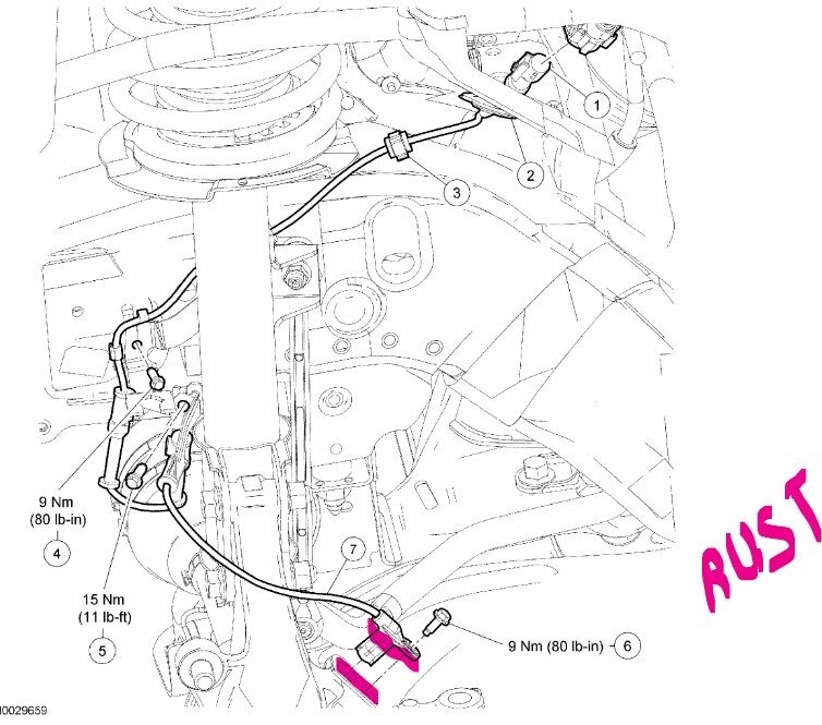

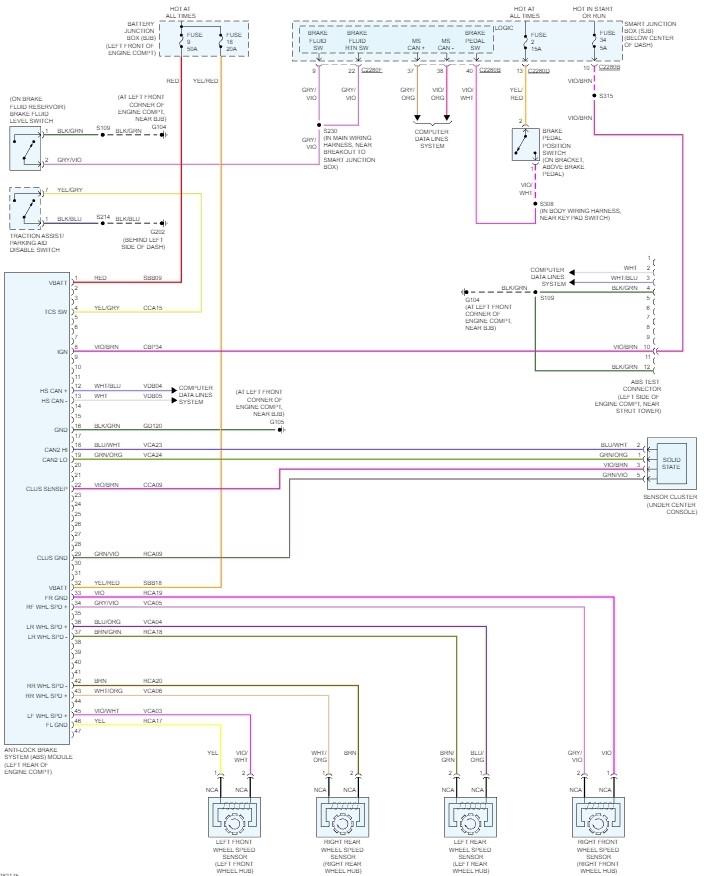

It is BS, it sounds like they replaced the front parts but never bled out the ABS system and the first time it activated it dumped the fluid into the air pocket in the ABS system. Because the pedal went all the way down I would have advised you to replace the master as well, but that would have been because of the crud and trash that settles into the cylinder over time and then you drug the pistons and seals over that when the pedal went down, but in my shop I would eat that cost as it would have been my fault for not following procedure and bleeding the system properly in the first place. Other shops won't agree with that. However, it sounds like the system still needs to be flushed and bled. Then if the ABS is triggering all the time, you still have a speed sensor issue where it thinks a tire is stopping before the others. I would find a different shop or take it to a dealer and have them do it. Around me the dealers have been getting much better on pricing but that may just be my area. Unfortunately, you need some special tools to bleed those systems and a way to look at the speed sensors and ABS system to see where that fault is. In my area of NY the common issue is rust that eats up the tone wheels in the front or rust jacks the sensors out of the knuckle. That gives the sensors a weak signal and when you slow down the signal level drops out on a single sensor, so say you are slowing down and at 20 MPH the signal is okay, then as you slow down 4 wheels show up at 15 but at 10 MPH one of them is showing a very weak signal and at 5 it drops out completely, the system won't flag it as the signal is there and the wiring is complete but it will activate the ABS because it thinks that tire has stopped rolling. The best way to see that is with a scan tool that can read the ABS signals.
You can try:
https://www.2carpros.com/articles/abs-wheel-speed-sensor-test
However, it may not show you the info you need unless you have an old-style analog meter.
As an example:
https://www.youtube.com/watch?v=oGwyrLxtaNY
https://www.youtube.com/watch?v=oXW0mqPrmPs
