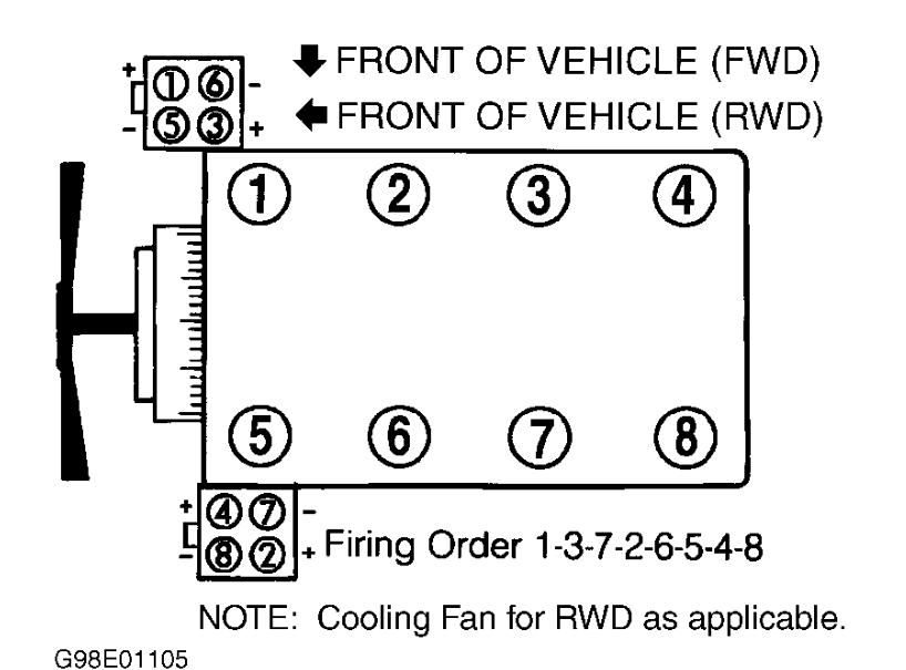

Firing orders I've been given. 1-3-7-2-6-5-4-8 and 1-5-4-2-6-3-7-8
Would like to know if anyone has a different firing order for this engine. A few years ago we had to replace the coil packs and forgot to mark where the wires went.
Recently we had to remove the wires again and the tape used was removed accidentally.
We were given firing orders and car would not start. Again this time is the same. A few years ago I walked into a Tire shop and the gentleman said he knew exactly which order I needed. He was kind enough to give me the information and I used it on the vehicle and it started no problems. The Tire shop went out of business and no possible way for me to know where the kind man is today.
For you information I checked against what I was given before the Tire shop and they were different. So if someone out there knows a different order please let me know. Thank you for your time.

The firing order is below. Check out the diagrams (Below). Please let us know if you need anything else to get the problem fixed.

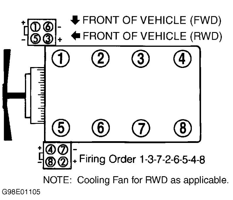

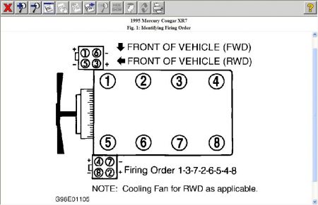

i have a 4.6 liter engine and i need the alternate firing order for this vehicle there are two firing orders for this year 4 8
3 7
2 6
1 5
6 3 7 2
1 5 4 8
Nov 27, 2020 at 8:19 AM (Merged)
  • 75,992 POSTS
Hi modular monster and welcome to 2carpros For a 1995 4.6L engine -see below

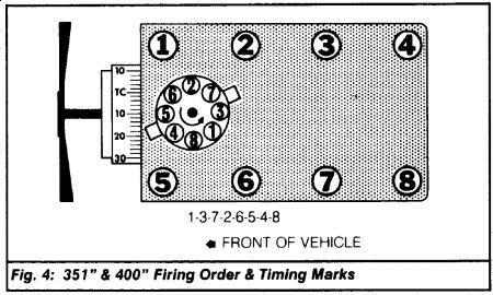

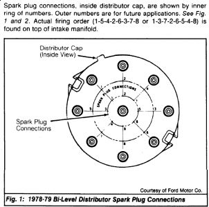

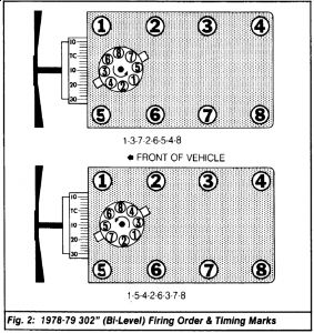

1979 Mercury Cougar V8 Two Wheel Drive Automatic

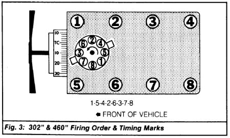

can any one tell me the fireing order of this car
MERLIN2021
  • 17,250 POSTS
I will give you all three, types, 351, 302, 460
https://images.2carpros.com/forum/automotive_pictures/62217_fo1_1.jpg
https://images.2carpros.com/forum/automotive_pictures/62217_302_1.jpg
https://images.2carpros.com/forum/automotive_pictures/62217_302b_1.jpg
https://images.2carpros.com/forum/automotive_pictures/62217_351400_1.jpg
It should be marked on the intake manifold in front of the carb!
