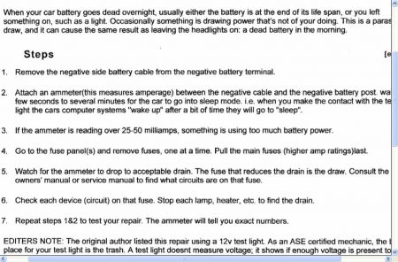

Load test the battery and alternator
The alternator might not be putting out or the battery is not taking the charge. If this 2 checked out as per the load test have the electrical system check for a parastic drain.
https://www.2carpros.com/forum/automotive_pictures/12900_parastic_draw_1_5.jpg
