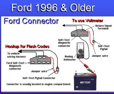

My check gage light came on and not long after the car shut off?What could this be or what is the check gage light for
Saturday, April 12th, 2008 AT 9:25 AM
MERLIN2021
MECHANIC
17,250 POSTS
The light comes on and will tell you what the PCM says is wrong! test like this...
