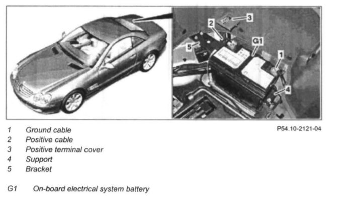

I keep getting a warning light that the battery is off line. I purchased a trickle charger but can't find the location of the battery, in the truck, to hook up the charger. I am putting the car away for the winter and want to keep the battery and computer charged.

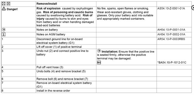

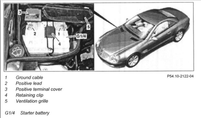

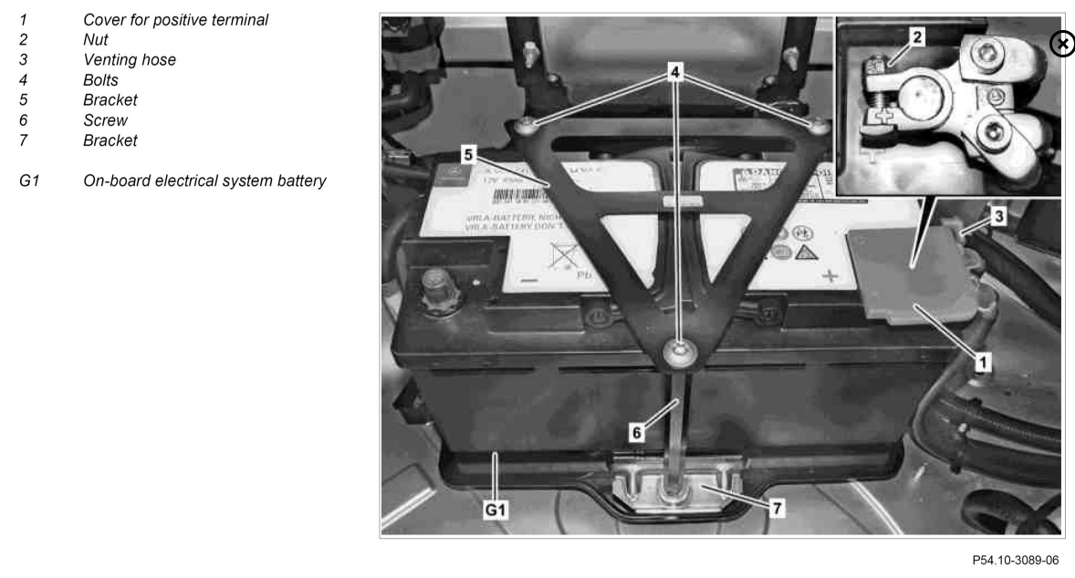

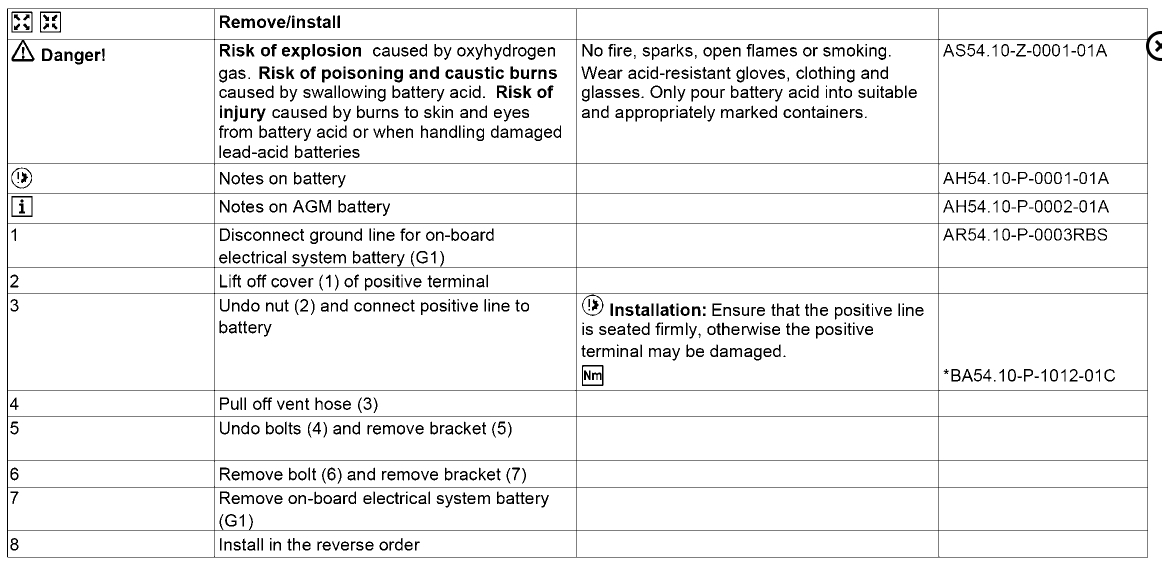

It looks like there are two batteries for this car one for the starter and the other for the electronics. Here is a guide that will help you see what you are in for when doing the job
https://www.2carpros.com/articles/how-to-replace-a-car-battery
You can load test the battery by following this guide.
Ann here is what it will be like for your car (Below)
