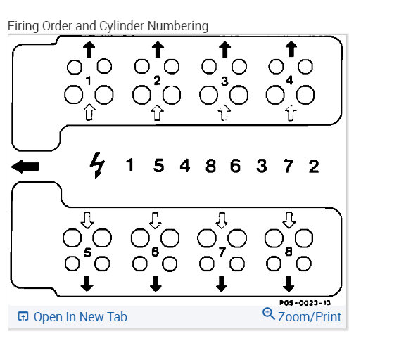

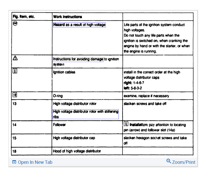

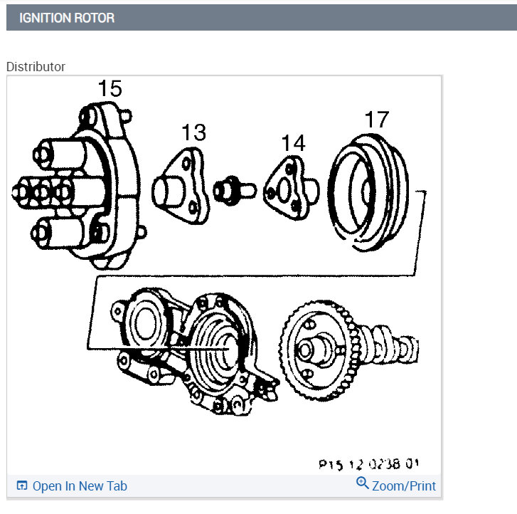

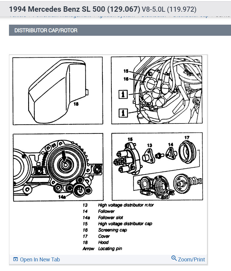

what is the procedure to replace cap and rotor?
Mar 14, 2010 at 8:57 AM
DAVE H
  • 13,384 POSTS
Here is the instructions on how to change out the ignition cap and rotor there is two of each on this engine. I have included the firing order as well. Check out the images (Below). Please let us know if you need anything else to get the problem fixed.
