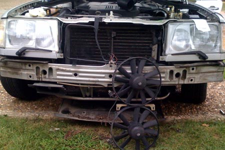

1994 Mercedes Benz E420 V8 Two Wheel Drive 92,000 miles
My air conditioning is intermittent. I have had the AC compressor and dryer, the control panel, the aux fan resistor and the manifold temp sensors replaced.
The AC may run for a while and then quit or it may not run at all or it may work fine all day. When the car is shut down and left off for a while the AC will most often come on and run for at least a few minutes after start. I have had the Freon level checked and the high end pressure is normal when the system is running.
Please help!!!

Is it the fan that stops or does it start blowing warm air?
Jul 21, 2009 at 11:50 PM
GRP914
The blower remains in it's last selected position the compressor shuts down and the system blows warm air.

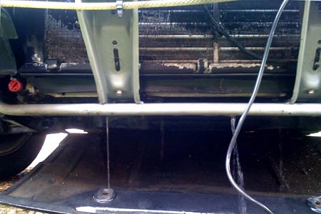

My e420 had the SAME EXACT problem it's like you were discribing my cars issue. I took the A/C condenser fan shroud off and found 3-4 inches of dirt packed into the condenser and between the condeser and the fan shroud. First I used a shop vac to suck the dirt out(you dont want to push the dirt further into the condenser) then i used a hose to rinse it off. Be carefull not to bend the fins on the condenser. When I did this it was a conplete difference, it works great now. In the first pic you can see what parts I had to remove. You can also see a small amount of the dirt that had fallen out and onto the ground and the plastic under skirt. The second one you can see the cleaned condenser with water driping off. Total of things to remove: Clips from top of Radiator, Clips from top of A/C condenser, Horns, body colored support beam in front of the condenser, front bumper, front of plastic underskirt, 2 Bolt's that hold the coil loop in front of the A/C condenser, condenser fan shroud(Difficult), condenser fan. If you do all this I sure hope it fixes your problem. Because it's a real task. It's important to note that the dirt was packed in th bottom and was not visible until the fan shroud was off.
