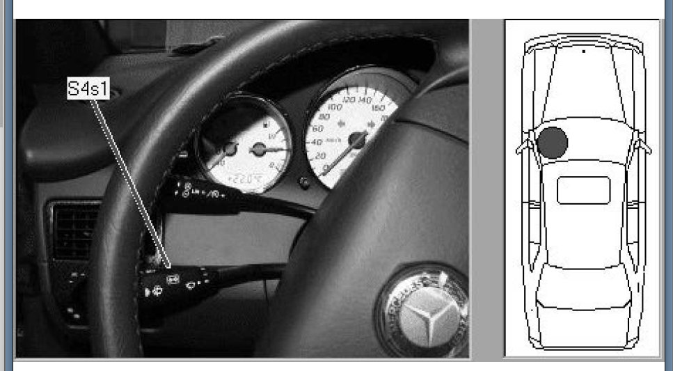

More than likely this is a turn signal switch issue. So, here is a video on a similar vehicle that will help with this:
https://youtu.be/pLDjYWv-ApQ
https://www.2carpros.com/articles/turn-signal-switch-replacement

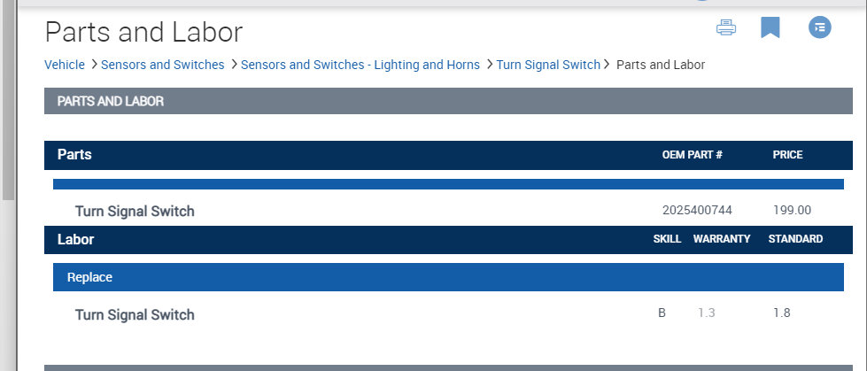

I am attaching some additional information about this switch below which will help with this.
However, the way to confirm this is to access the switch and check the voltage coming from the switch

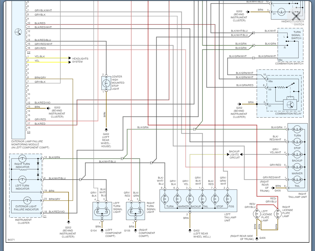

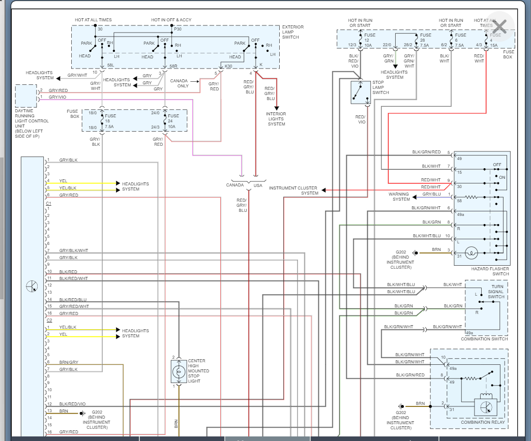

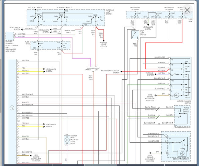

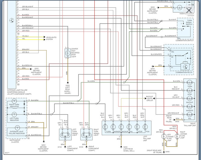

Please find the wiring diagram attached as well so let's start with this info and we can go from there.
