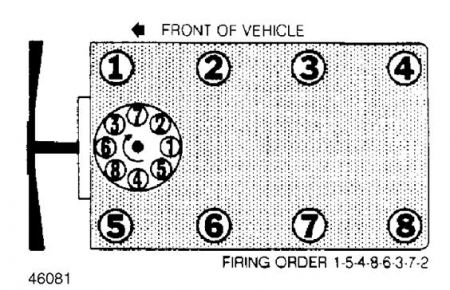

V8 two wheel drive Automatic 140,000 miles.
I am trying to put the spark plug wires in the correct order. I was told that the firing order was located these number on the cover from left to right (1,5,4,8,6,3,7,2) is this the correct firing order? if so how do I follow ie, which is right side, left to right. Please help.

https://images.2carpros.com/forum/automotive_pictures/12900_fo_156.jpg
