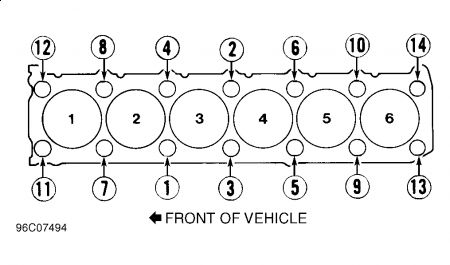

Hi all
My merc 280 has a oil leak out the back of the head.
I need the head bolt torque Please.
Thank You

The bolt pattern is as follows:
https://images.2carpros.com/forum/automotive_pictures/294900_202_head_bolt_1.jpg
The first torque will be 41 ftlbs. Then go back over in the same pattern tightening another 90deg turn Then for a second time go back over another 90 deg turn. This is the proper torque procedure.
