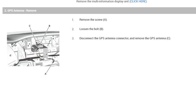

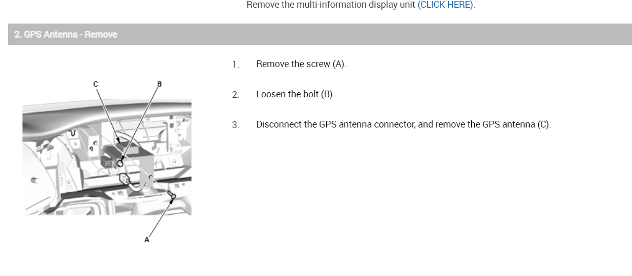

I had these little "mochi squishies" which are like little rubber toys on my dashboard, as it got hotter outside, they melted, and I took them off as soon as they started. When I removed the toys there was a bumpy mark almost as if it melted my dashboard. Is there a way to fix this?
May 17, 2023 at 3:18 AM
  • 55,402 POSTS

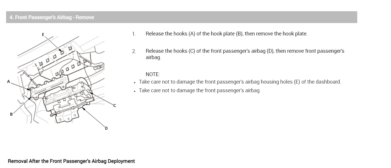

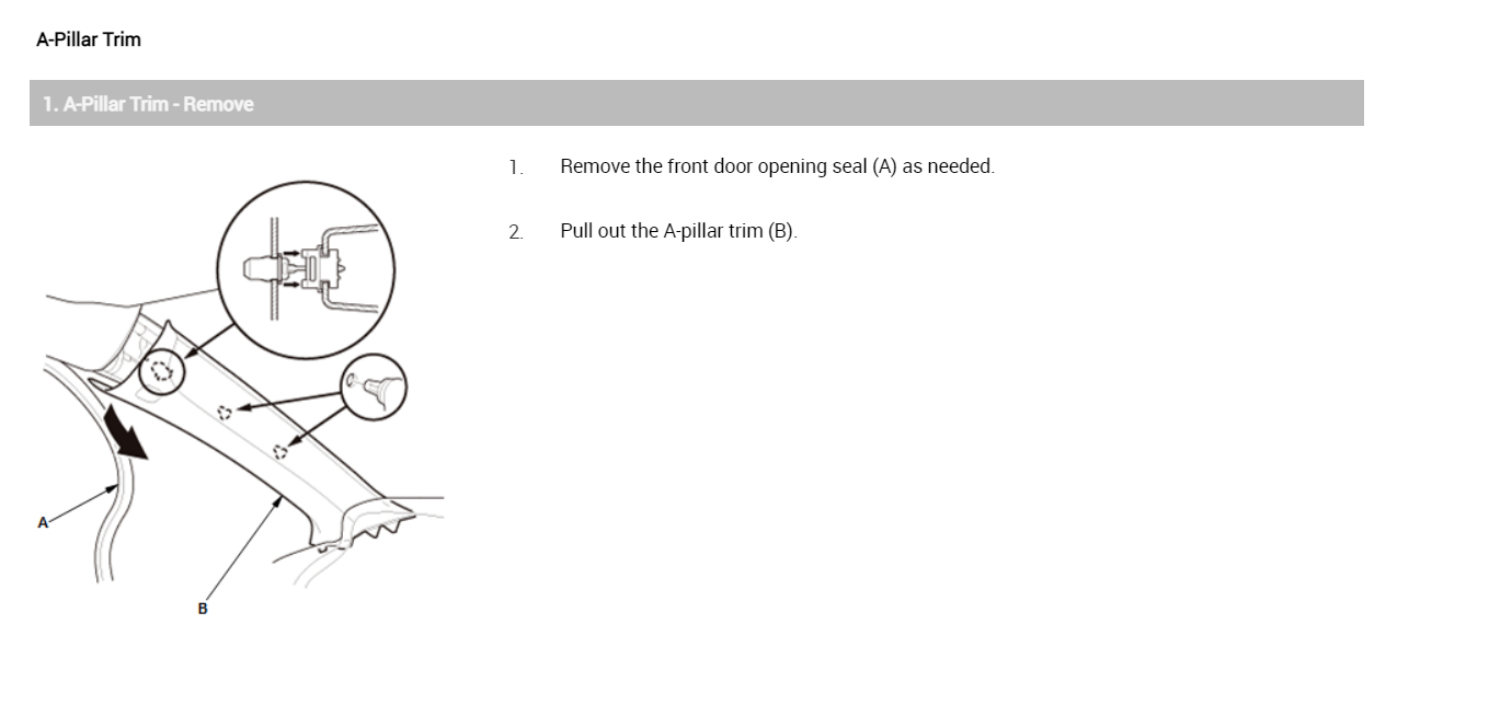

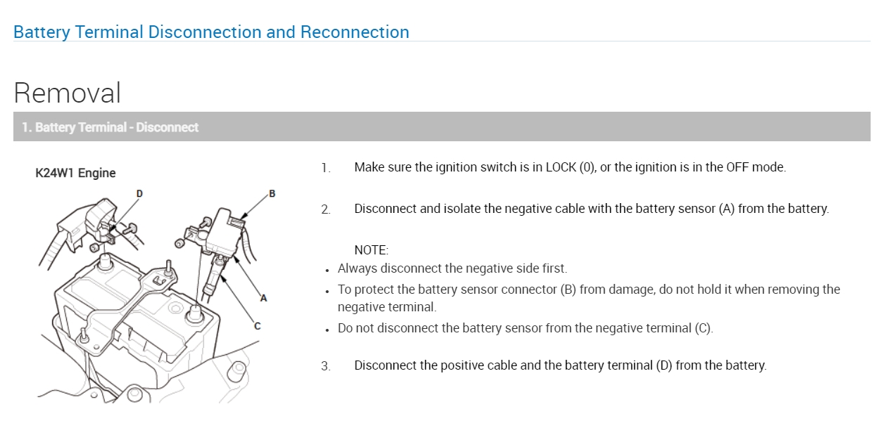

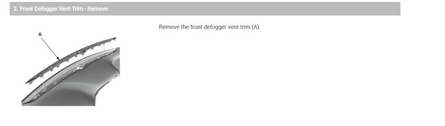

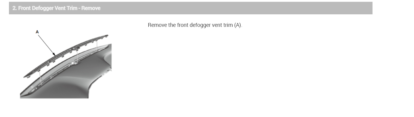

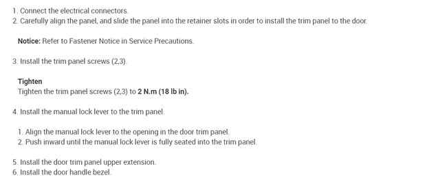

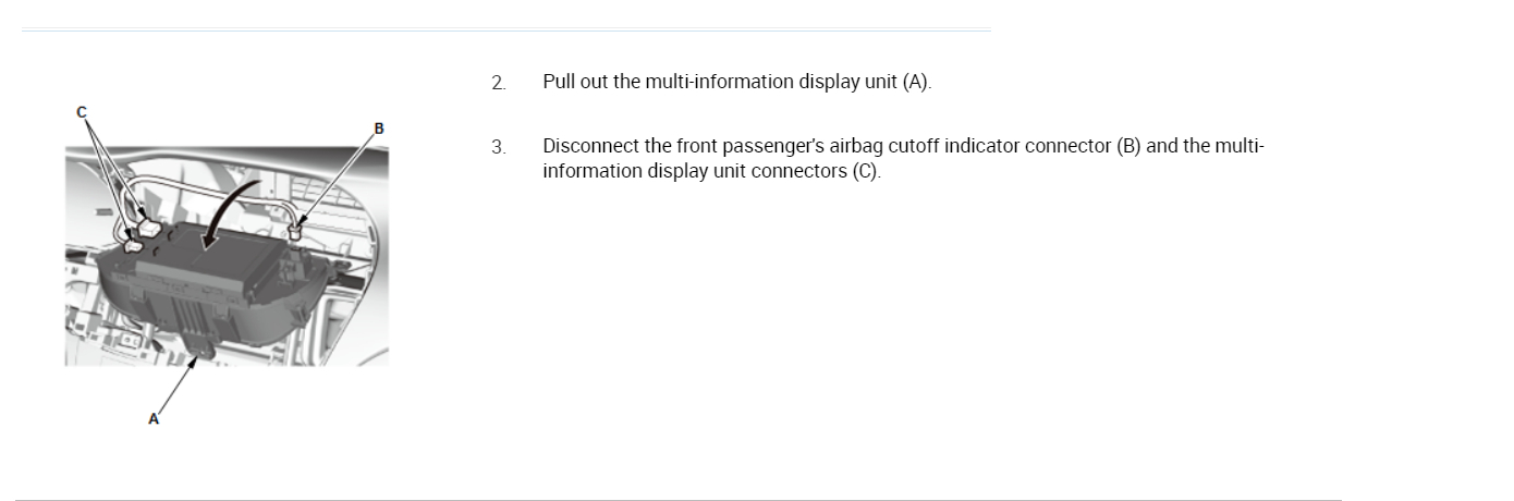

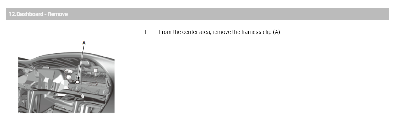

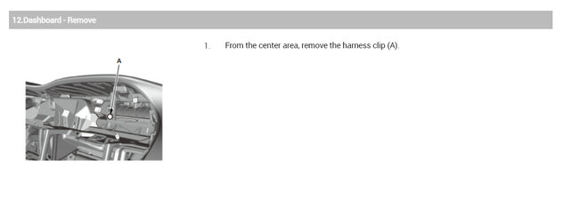

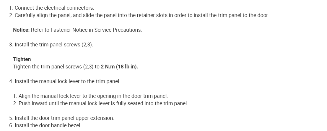

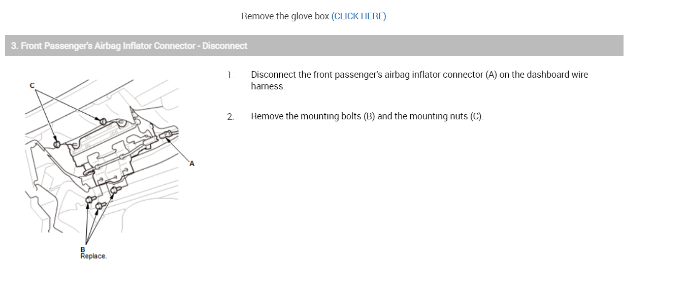

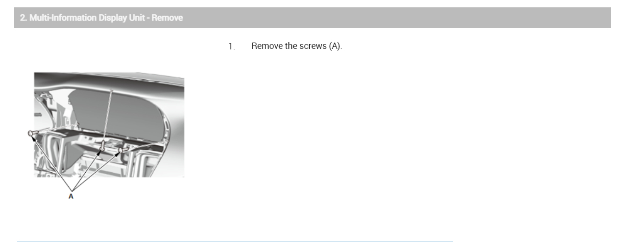

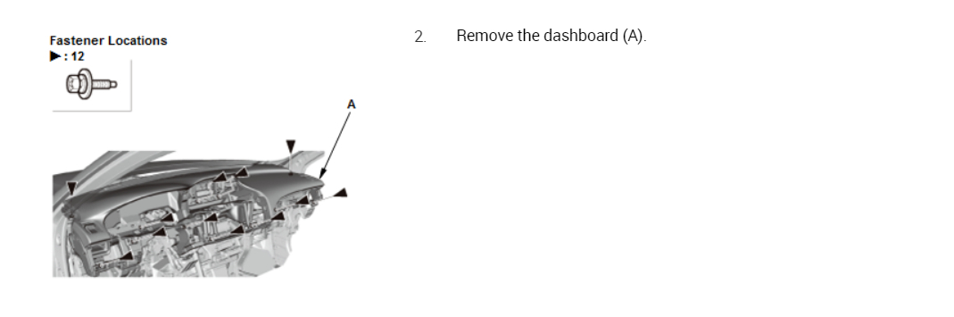

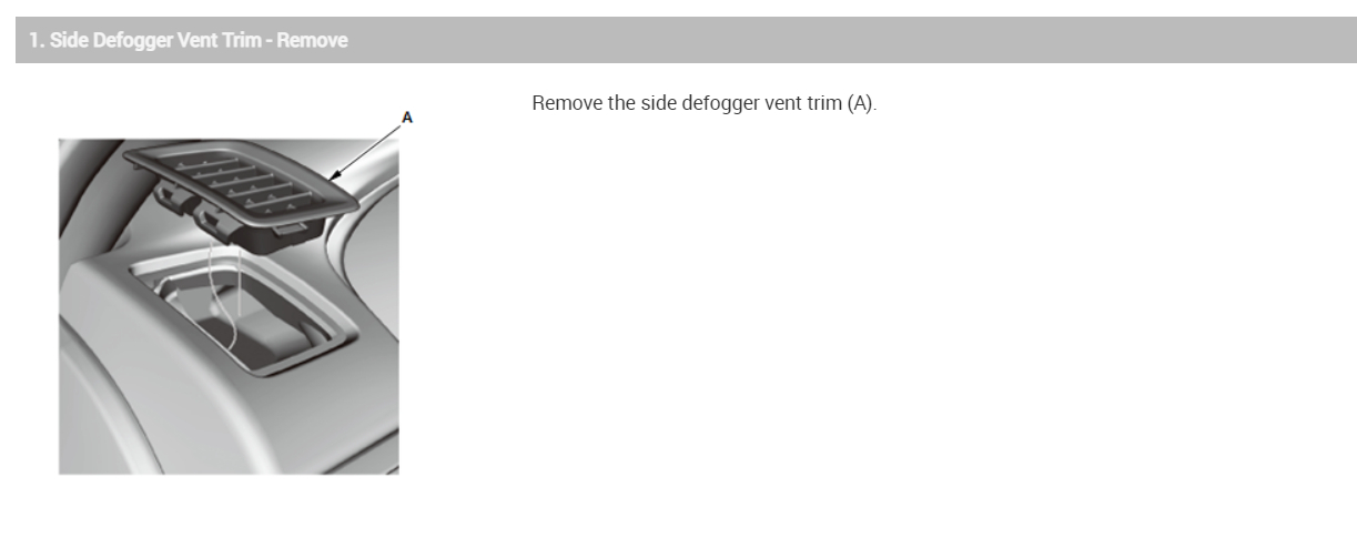

It depends how bad the damage was, can you upload an image so I can see. If it can't be fixed. here is how to change out the piece to fix the problem. Check out the images (below). Let us know what happens and please upload pictures or videos of the problem so we can see what's going on.
