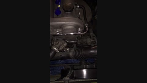

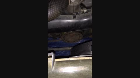

Can you post an audio recording of how the starter sounds when cranking over with spark plugs in?
May 19, 2018 at 3:16 AM
MAXWELLMCKAY
  • 7 POSTS
Here is the requested video.
May 19, 2018 at 7:50 AM

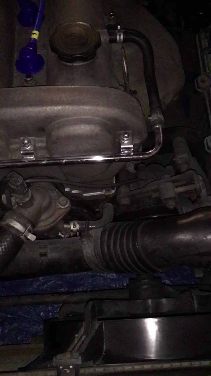

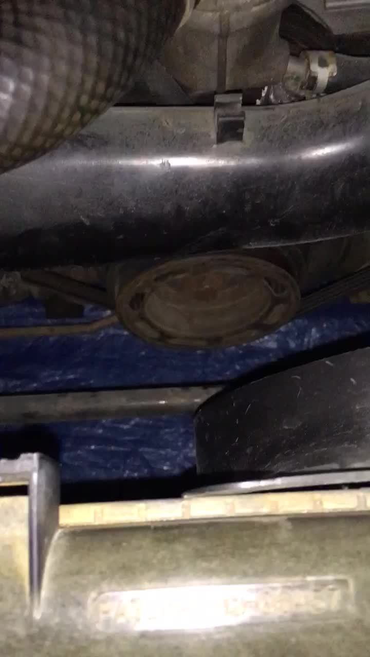

You mean to tell me the belt is moving when you do that, because that does not sound to me as though the starter is cranking over at all.
Can you post another one except this time since it is a video, show if the belt is moving or not along with that noise.
May 19, 2018 at 8:04 AM
MAXWELLMCKAY
  • 7 POSTS
Here is the next requested video. Thanks for the help by the way.
May 19, 2018 at 8:32 AM
PATENTED_REPAIR_PRO
  • 1,853 POSTS
Check how much voltage is present at the starter when doing that, where the big positive battery cable is located on the starter.
