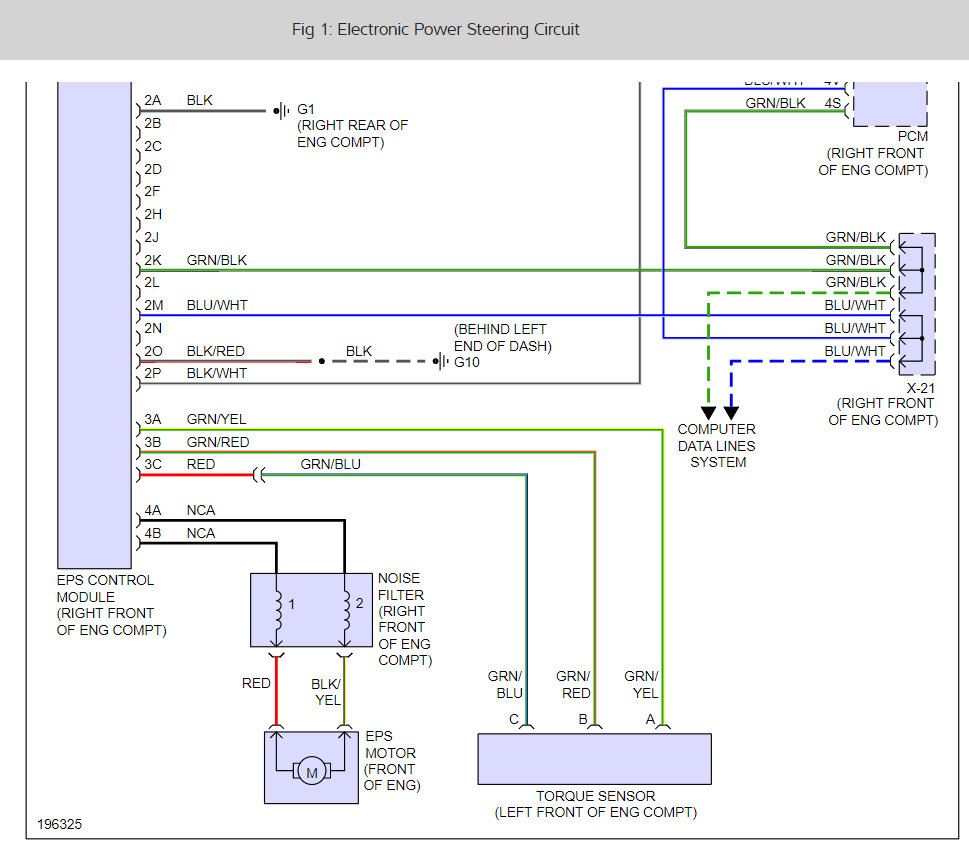

Power steering is gone out again. Light on on dash. Replaced fuse, still having problem.
Jan 17, 2009 at 5:07 AM
  • 55,748 POSTS

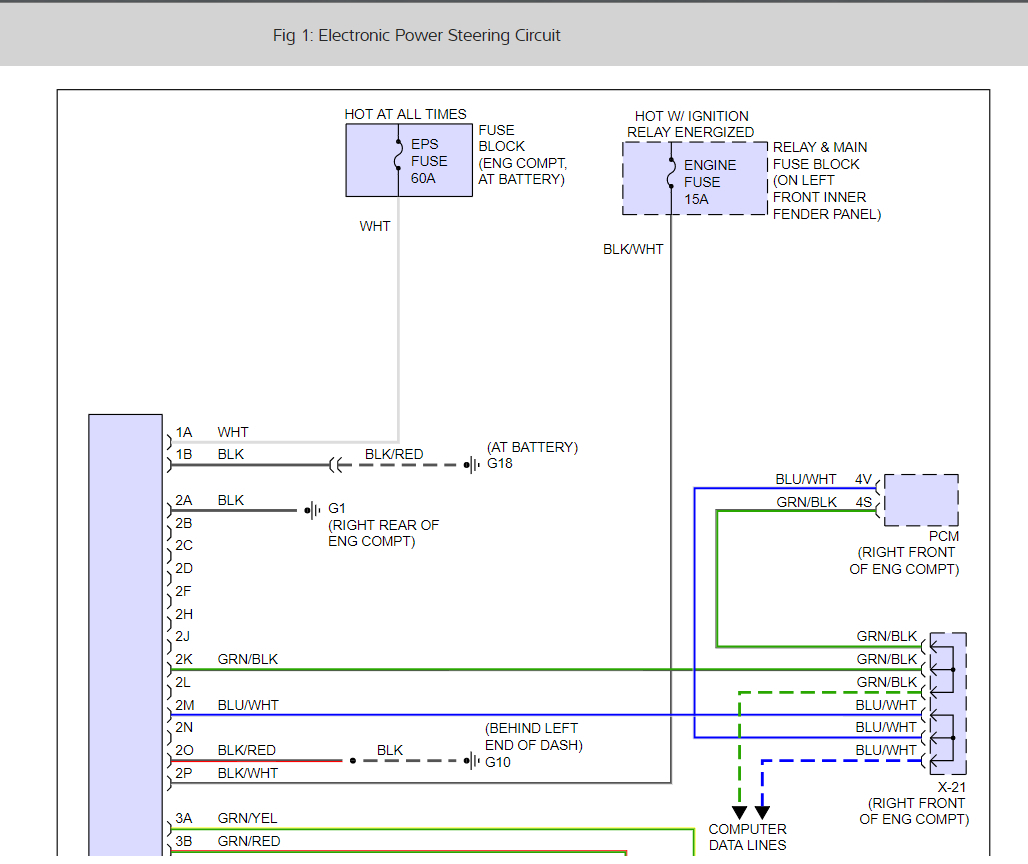

It is probably your steering unit, the motors burn up inside and it causes the unit to keep blowing fuses.
Here is a wiring diagram of the system so you can see the components and how they are wired. (below)

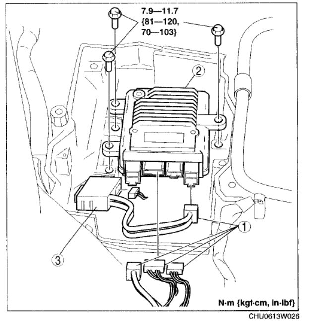

Just in case though unplug the controller and see if the fuse still blows.
Here is the location
