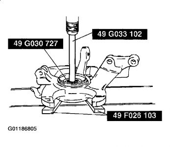

As for the axles do they click? What you do is come up to a stop and do a turn left and then right seperatly of course. Now when you go to turn give it a little gas like you miss judged the car coming and have to get in a bit do you hear any clicking on take off? Now on the hub assembly that is a bit harder but what you can do is jack the car up and then have a friend help by having them turn the wheel and use either a long screw driver with the screw driver up against the hub and the you hand cupped over the handle and placed against you ear or use an automotive stethiscope. Now have you friend turn the wheel and listen for growling or grinding sounds. Here is a pic of the hub so you can get an idea of where to up the screwdriver or the stethiscope. If you look at the pic all you need to do is put the screwdriver up against this part where ever it is most convient. Let me know what you find.
https://images.2carpros.com/forum/automotive_pictures/249564_Graphic_124.jpg
