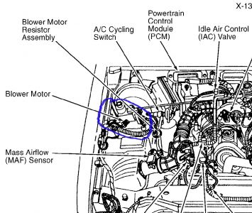

Started my Mazda B2500 pick-up this morning after a truck was outside all winter. Tried the AC and got a growling and squealing sound. Also looked like blue vapors coming out of vents.
Under the hood found a squirrel nest with many acorns near the firewall passaenger's side.
Fuses and reayys all ok
Can you tell me where the motor blower is located?inside or outside the cab? Is it much effort to replace?
Thanks, Don

IT's mounted from the firewall side on the right of it. Should take about an hour or so.
https://images.2carpros.com/forum/automotive_pictures/30961_111blower_1.jpg
