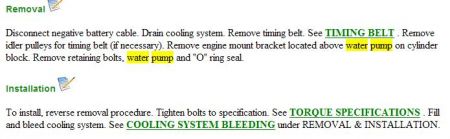

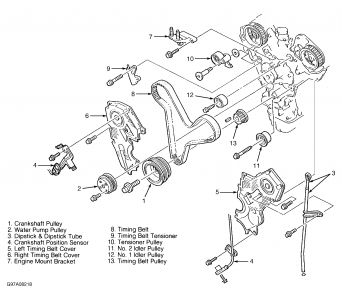

the car over heated but the over flow tank is full so i checked the raidor and it was empty so i added some fulid to it and the fulid was draining out of it i have had to change the harmonic balancer a few weeks ago and it looks as if its coming from behind it? is the water pump near the balancer and if it is where can i find a diagram on how to replace it? any advice will help

HI there, The water pump is driven by the timing belt see pics for details. mark (mhpautos)
