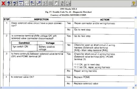

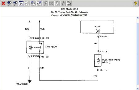

when i am driving, the cel comes on at 2.5rpm if i step on the gas it goes off. the car also hesitates at 2.5rpm. i have changed several sensors. i dont know what is wrong, the engine code is reading 41.please help.
Dec 11, 2007 at 3:09 AM
  • 75,992 POSTS
Code 41 applies to the solenoid valve VRIS see below
https://images.2carpros.com/forum/automotive_pictures/12900_code_41_flow_chart_1.jpg
https://images.2carpros.com/forum/automotive_pictures/12900_Code_41_schematic_1.jpg
