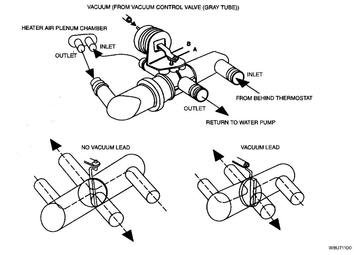

I can only get cold air out of my vents, even when I have the dial cranked to full heat! It's not a problem right now but Winters coming. Any suggestions as to where I should check first?
Aug 16, 2010 at 7:39 PM
  • 75,992 POSTS
Be sure both heater hoses are getting hot, If only one is hot you may have a plugged heater core or heater control valve that isn't working.
Read the guide below, it will help.
The heater control valve is pictured below

I would say that you have an air lock in the heater system, try bleeding the cooling system with the front of the car elevated slightly, when the heater is purged of air, with the heater on, both hoses going to the heater will be hot to touch.

Check the following: thermostat, heater core,heat control valve if it has one and also if the air blend door is opening to the heat position-start ere
