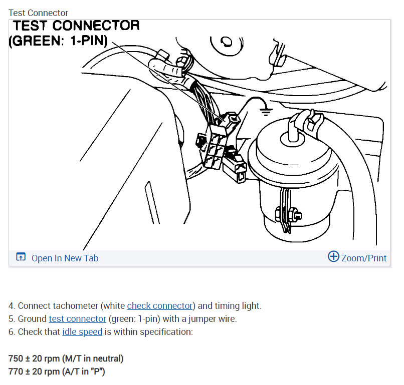

What is the correct timing for this truck?

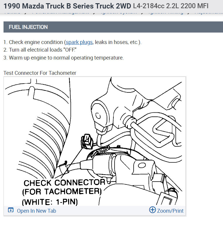

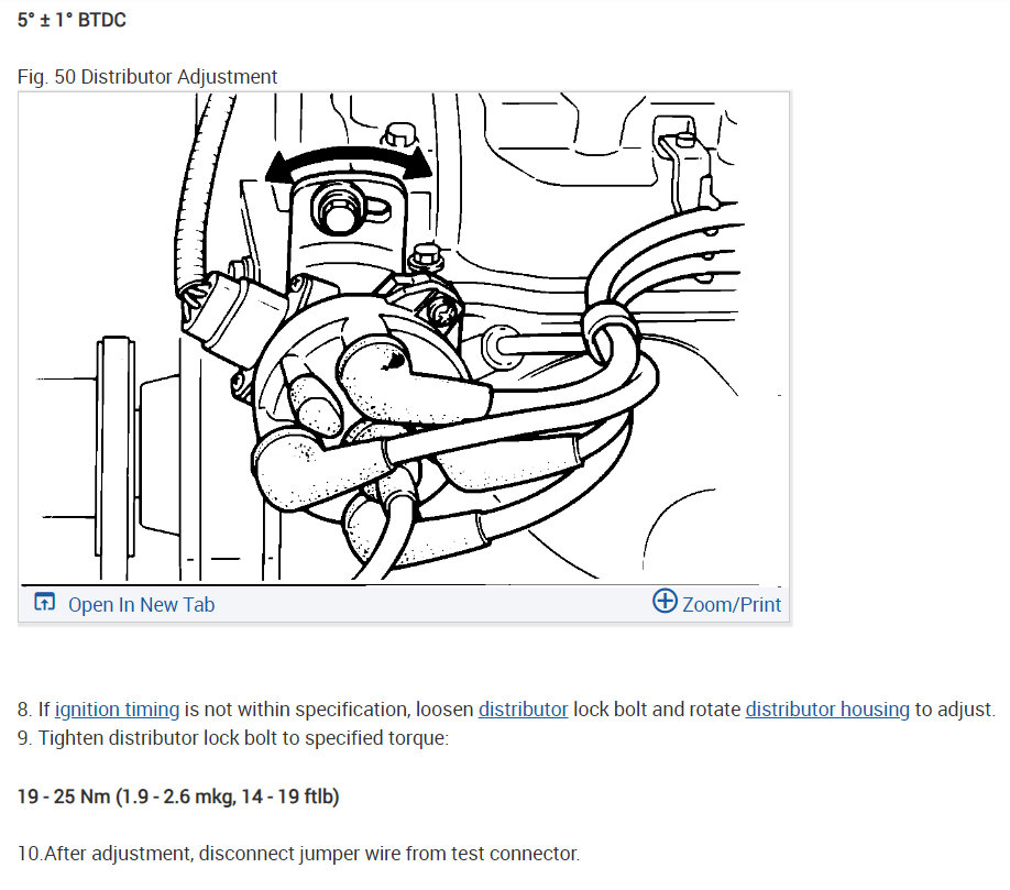

CARBURETOR
1. Check the condition of the engine (spark plugs, leaks in hoses, etc.).
2. Turn all electrical loads OFF.
3. Warm up the engine to normal operating temperature.
4. Connect a tachometer and timing light to engine.
5. Check that the idle speed is within specified range.
825 ± 25 rpm in park (A/T) or neutral (M/T).
Check out the images (below). Let us know if you need anything else.
