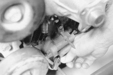

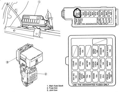

PCMs have an internal driver circuit for grounding (or in some cases energizing) the injectors. Problems here can disable one or more injectors depending on how the system is wired. In some cases, a shorted injector will kill the driver circuit in the PCM. And don't forget the power relay that supplies voltage to the injectors. If this relay dies, it will disable all of the injectors and that is here our case. First check the fuse fuel inj 30A in the fuse box. If the fuse is good, replace the main relay. The relay is located under the dash, near the fuse box. That is the quick way to find out if the relay is bad https://www.2carpros.com/articles/how-to-check-an-electrical-relay-and-wiring-control-circuit
https://images.2carpros.com/forum/automotive_pictures/46384_0900c15280076dfc_2.jpg

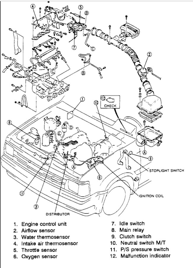

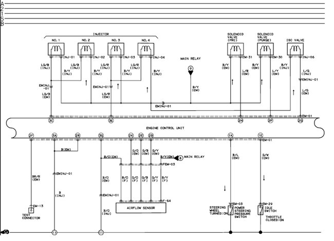

Check out the diagrams (Below) Please let us know what happens. Cheers

The white and green wire is from the 30 A injector fuse. The 2 W/G wires goes to the relay (Main relay) It is on the wiring diagram and in the diagrams below.
https://images.2carpros.com/forum/automotive_pictures/46384_fuse_2.jpg

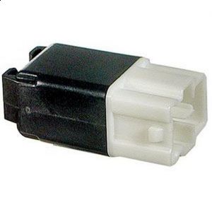

Relay
https://images.2carpros.com/forum/automotive_pictures/46384_relay_3.jpg
This is the relay you need. You can find it at Auto zone if the relay is replaced, the fuse is replaced and still there is no pulse to the injectors, the crank sensor might be bad. Computer relies on crank sensor signal to activate the injectors. The Crankshaft Position (CKP) sensor, located on the front cover (near the crankshaft pulley)

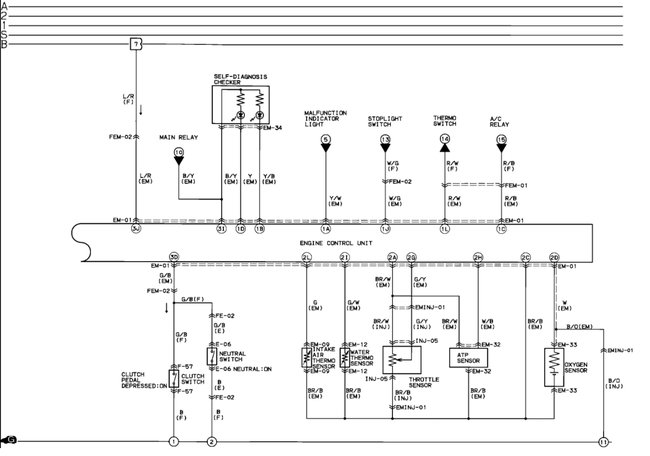

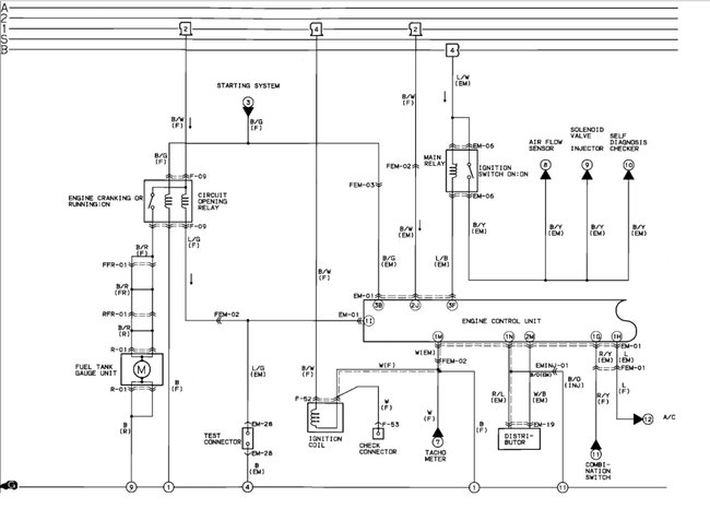

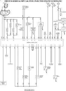

I have send diagrams to your email, show them to the neighbor mechanic.
the diagram is correct for 1989 Mazda Truck B2600I 2.6L FI 4cyl

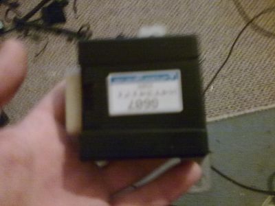

SLEDGE302000
  • 6 POSTS
dont have a cranksensor and there is no pink wires in the harness.it does have a fuel injector cutour relay that i know of i will send a pic of that there is a module pickup the temp and other montering sensors the 3 fuse mainblock and the injector wiring plus the lights thats all thats in the motor area.u think that the cutout relay takes place of the cranksensor.if i strait wire it to the 2e and 2g pins on comp will it work. there are 2 wires that match the colors on the connector. just to see if that makes it work.u are helping alot im sorry if i am giving u a hard time
https://images.2carpros.com/forum/automotive_pictures/452833_Image005_1.jpg
this is a japan truck the newer models are ford i have done my homework on this truck i can fix anything else on this truck easy just dont know the injector system if i had anything else to drive i woulda burnt it down already

SLEDGE302000
  • 6 POSTS
the 2 wires i said i said wrong wrong diagram the 2 i looked at was the clutch safety switch/still u think that that might work if i did that strait wired that fuel cutout relay to the comp.at least to run a voltage test or 3.the place on my truck where the crank sensor is a oil pressure release. I finally looked at the mount where the main relay plugs into and it was corroded. so it cleaned it and it works! thanks for hanging in there with me. I love this site.
