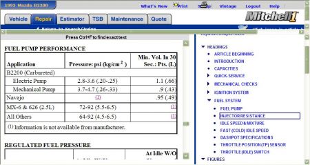

Have cleaned carb, replaced needle & seat, and all gaskets and "O" rings, checked float to be sure that it floats, Checked fuel pump pressure and it was only 1 to 3 lbs. tried a new after market fuel pump just to see if it made any difference and it did not. Did not think it would. Engine runs for short time only until the flooding kills the eng. then you have to wait for a while the fuel evap. Replaced the ox sen. took the computer out and looked at the board inside for damage, none shows. The fuel in the sight glass on the carb. seems to stay at the right level. Is something in the carb. or is it the computer? Or is it something else that I have not thought of? I am 70 years old and can not afford to wast money on wild guesses. My SS check will not go that far.

If its flooding out the fuel will rise above the sight glass line-No pin hole on the float and needle seating properly-still points to internal problem with the carb- What do you have an electric fuel pump or mechanical pump?
https://images.2carpros.com/forum/automotive_pictures/12900_fuel_pump_10.jpg
