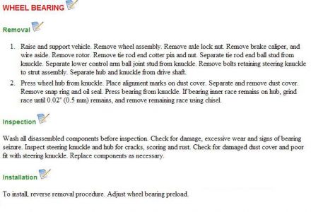

We have a 2000 Mazda 626 with 108,000 miles and the front wheels are making a lot of noise. I used to have a 1987 Mazda 323 and had a similar problem for which I changed the wheel bearings and it solved the problem. I was wondering how difficult is it to change the front wheel bearings on the 626? Do I need any special tools such as a bearing puller or hand press? If I don't do the work myself what would be a fair price to pay for this work? Any help would be appreciated.
Thanks...Tom

Hello Thanks for the donation Below are the repair procedures as well as an estimate (including labor and parts) for replacing your vehicle's wheel bearings.
https://images.2carpros.com/forum/automotive_pictures/261618_Noname_421.jpg
https://images.2carpros.com/forum/automotive_pictures/261618_1_32.jpg
