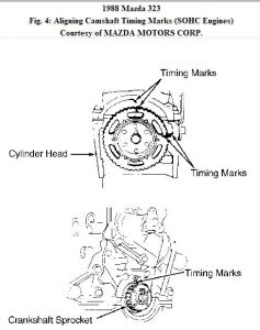

How do I match up timing when I change timing belt I can see the mark on top but not on the bottom which is the camshaft. The car starts but won't run the best so I 'm guessing the timing is off. Please help.

Hello, Here is a diagram of the timing marks....

I see the mark for the cylinder head but on the crankshaft I don't see the mark on sprocket what kind of mark is on the spocket & also the car did start but it's hard to start it's like it flooding out is that because it 's to far advanced.

[quote:6ba65dce21="bobndianee"]I see the mark for the cylinder head but on the crankshaft I don't see the mark on sprocket what kind of mark is on the spocket & also the car did start but it's hard to start it's like it flooding out is that because it 's to far advanced.[/quote:6ba65dce21]
Not exactly sure the marking on the sprocket. However, the keyway that keeps the spocket from spinning should be straight up. If the spocket has a backing plate attached to it look on it for the mark it.
